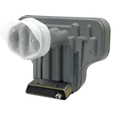

SL5 PIG-Z LNB

So this Slimline SL3 will work and I would use it with the Inserter P121R1-03 SWM ODU Only ?
Yes.
