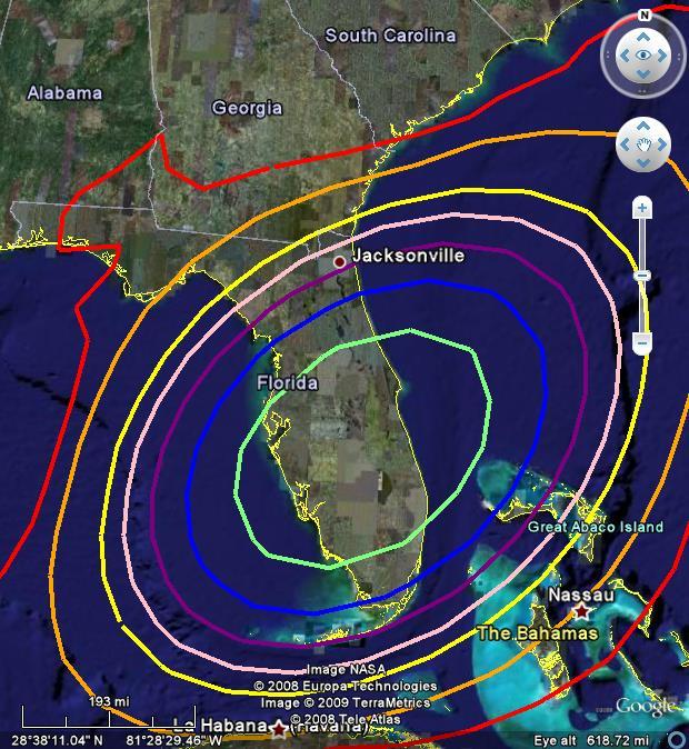

About the only thing that limits size is money, but you should be able to blow the socks off with your 1 meter on TP1 at 110. Jacksonville receives about a 54 dBW signal strength from that spot. Check your alignment.

The 1M dish was impressive on the CONUS transponders 125 max on all. It also improved the spots that carry Tampa Orlando Ft Myers ect. Those were faint on the small dish but great signal on the 1M dish. Spot 12 where the Miami HD's are located did not lock at all max signal was 40 and it bounced.
