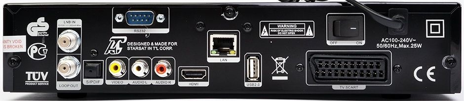

I have this satellite Starsat HD 2000 Ace.
What is the "Loop Out"?

That is to loop out to another receiver.

The receiver connected to the loop through can only see the same polarity as the master receiver.

The loop-through typically introduces substantially more noise and cascades the insertion losses. Loop-through is fine for a 2nd receiver, though I always use a 2x1 - APPP (all port power passing) for my personal set-ups.
We install hundreds of 4 DVBS receiver commercial rack mount systems each year in US State and Federal prisons. These receivers are tuned to 4 channels originating on the same transponder. The signal SNR is significantly better on the 3rd and 4th receiver when a 4x1 - 1PPP (one port power passing) splitter is used instead of looping receiver tuners 1 - 2 - 3 - 4. We only approve installs completed with a splitter or multi-switch.
