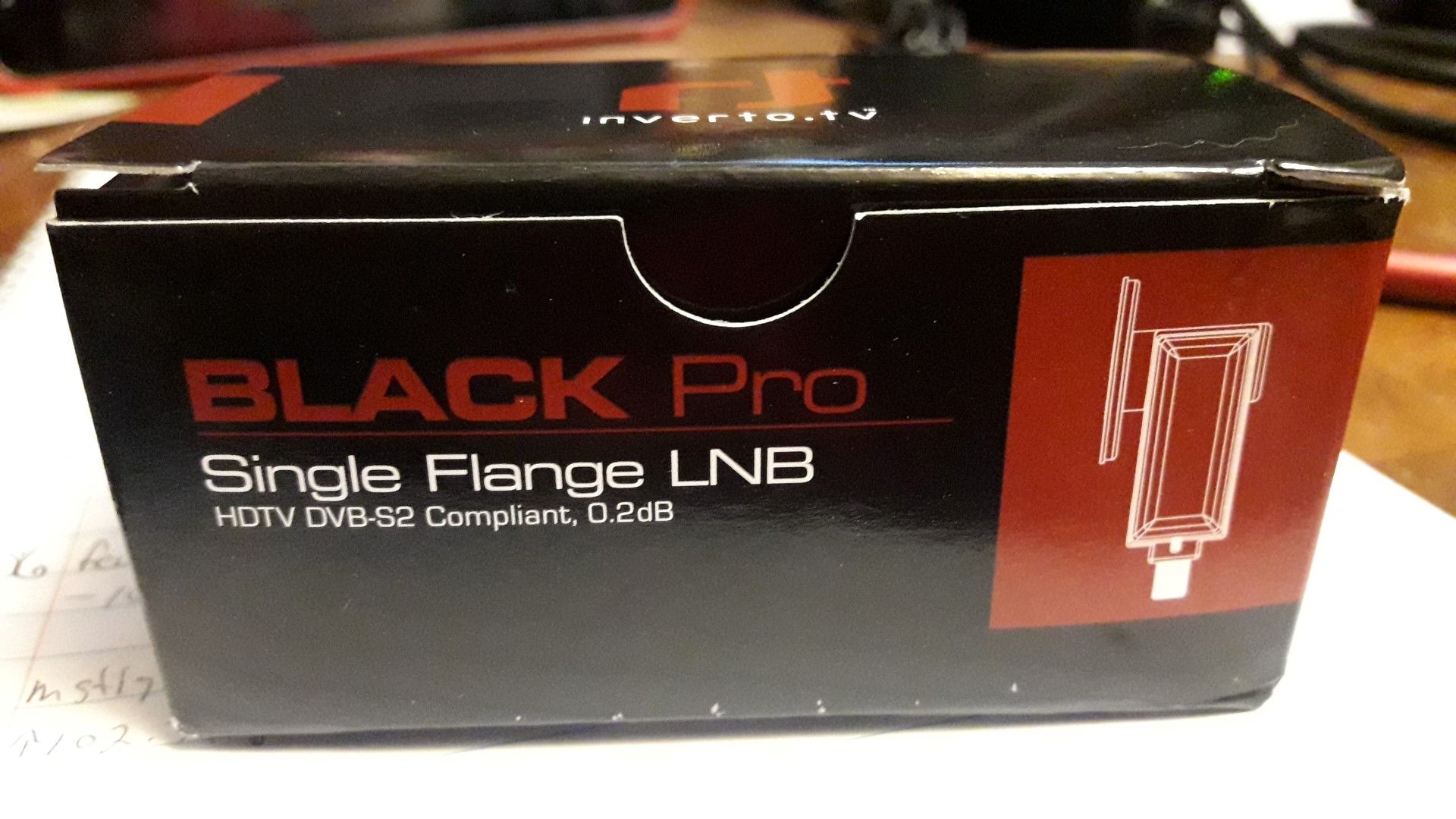

If you get it, keep the feedhorn. It works best for that dish and you can use an Inverto LNB that bolts right on giving you both polarities.

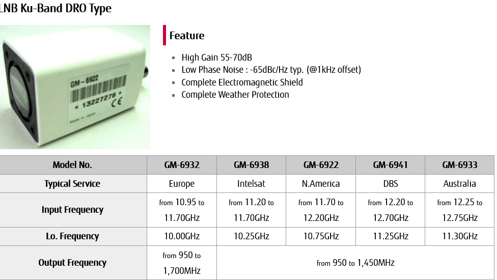

Depending on how you search it's a Norsat or Fuitsu Ku LNB. If it's the LNB you're interested in knowing.
