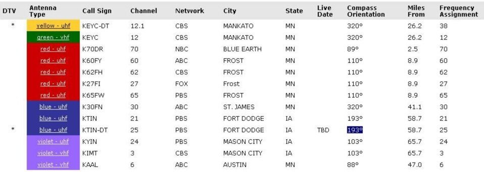

Well CBS is at 320° and 27m and @ 110° and 9m via a repeater that likely does not pass along digital (not 100% sure). ABC, FOX and PBS are also on that same repeater location. NBC appears to be on another repeater location. The PBS digital is showing to be at 193° and 60m. I am betting that you are going to need more than that antenna to get any quality results as it will likely not acheive 60m to reach that actual IA market and is also highly directional as well and his signals are scattered all over the place. If those repeaters do pass along digital then you may have some luck aimed at around 100°. I attached your zip code results from antennawb. They are ugly.

So now the OP is just back being in a badly laid out DMA for OTA reception and having an OK, but not great antenna, and likely not what he needs. Does anyone know if repeaters pass digital?
