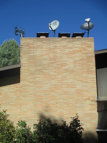

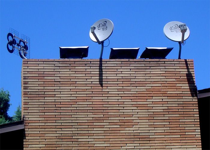

And it just occurred to me I wonder if the tech roll is with intention of installing my first H3? OF WHICH I told her that I was waiting until the weather got better before I'd make a tech climb a ladder 40' up the side of my chimney to change out the LNB and node since they don't do roofs. Which from the roof side the area that will be worked on is waist high there. Oh well. But then the last guy, that said he was a trainer and had a Supervisor come out too, said it was going to be a 9 hour install until I told him how we were going to do it, so 2 hours and 45 minutes later he was leaving. Most of his time was to drill into the cap on the top of my chimney for the new dish, that he would have had 10 dishes install by then normally. I told him the concrete was the real stuff. Then he stated to swing from it and said that he'd mark that down as an anchor point. So maybe the next guy can use it as that. But that's in the Spring.
I've got a chimney mount. Of course it's been there for nearly 20 years.... I've had techs out to upgrade things along the way and they never blinked....
I moved mine from the fascia to the chimney in 2003 when we had the roof redone. I too have had many techs and Field Supers out including when we got the HwS conversion done by a "Trainer" with a Field Super watching. And before that DISH put the second dish up there when 129 went on line. The only objection was for the new 1k2 the newer chimneys they use a weaker form of cement to cap them and the techs experience was that it is not able to support a dish. Back when my house was built, over 50 years ago, which 50 years is when concrete fully cures, they only had one kind of concrete and it was used everywhere. So the tech said he try I had two 500's up there before installed by DISH, but not very well. He climbed up the ladder when he could have stood on the roof and had it all at his waist. I took all the gear up with me and handed it to him. Well he got a lesson on old school concrete. And while doing it he scared the hell out of me by stand on top of the ladder while drilling. He remarked, jokingly, that in the time that it took him to drill down 1/2" on the first hole, he would have installed 10 dishes under "normal" circumstances. When done he grabbed on and gave it a good tug and jumped around on it and said it could qualify as a safety mount. When they do the H3 upgrade they are going to remount, as the 1k2 is on the wing dish. When it went up they didn't have the heavy duty hardware they do now. (tried to use thumbnails, but they failed)
