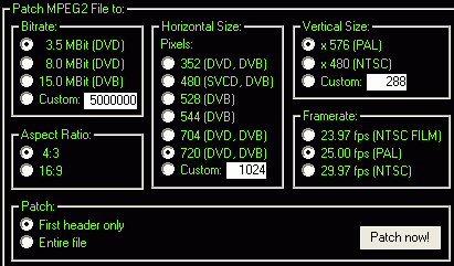

Thanks for that info.
I recorded off FTA about 45mins or so, and yield about 1.36GB.
I was able to record that content into a DVD-R by simply using the following.
DVDPatcher
Patched it to DVD Complaint, used TMPGEncDVDAuthor 1.6, then burned to DVD-R.. done deal. :yes
