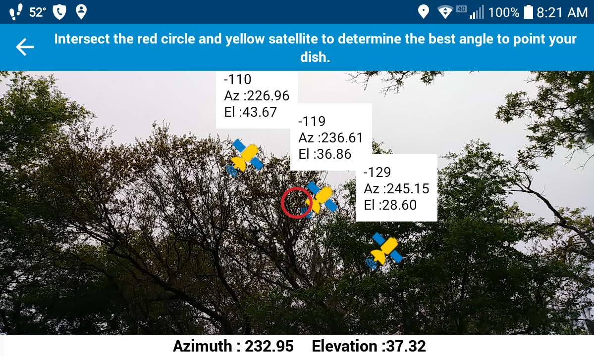

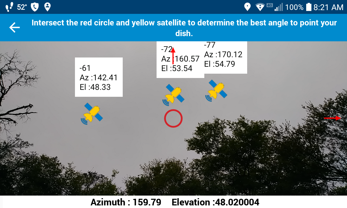

You could download the free Winegard TV Signal Finder App to your phone and use the augmented reality feature to see if the dish has a clear view of the sats.
Thank for reminding me about the Winegard application. I had forgotten about them since my Ku FTA dish was set up a few years back. As it turns out it looks like we're going to be ok since the satellite is above the tree line, not by much mind you but above. The trees are pretty old so I don't think they'll go any higher.
Again thanks to everyone who contributed.
