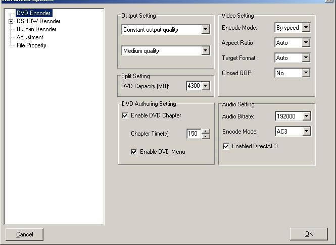

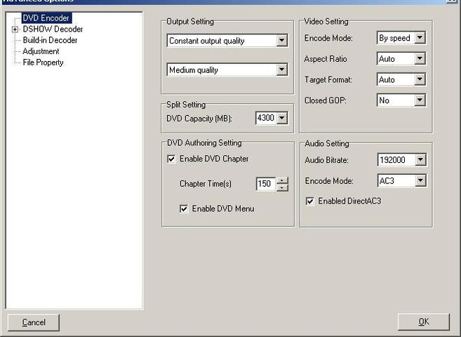

Normally, I use WinAVI in the "convert to DVD" mode.
Press the big DVD button on its start-up screen.
Then, on the next screen that lets you select your output directory and format, make sure the output format is: DVD !
That's a drop-down box, and do not choose any other format.
Next, click the Advanced button
On the DVD Tab, if you've been mucking with things, you might be better served by just re-installing WinAVI to get back to the default settings.
If not, here are some guidelines:
- Constant video quality: select Lower for first test
- Split output file: check
- Size : 1013mb
- Constant Video Size: UNchecked!
for the rest of the settings on that tab, I use:
Set chapter length: check
300 seconds
Target Format: Auto (only if that doesn't work, you might try forcing NTSC mode)
Audio Bit Rate: 192000
Aspect Ratio: Auto ( only if that doesn't work, try 4:3)
Enable DirectAC3: check
On the Encode Tab, leave all settings alone !
and if you've messed with them, put 'em back! :cool:

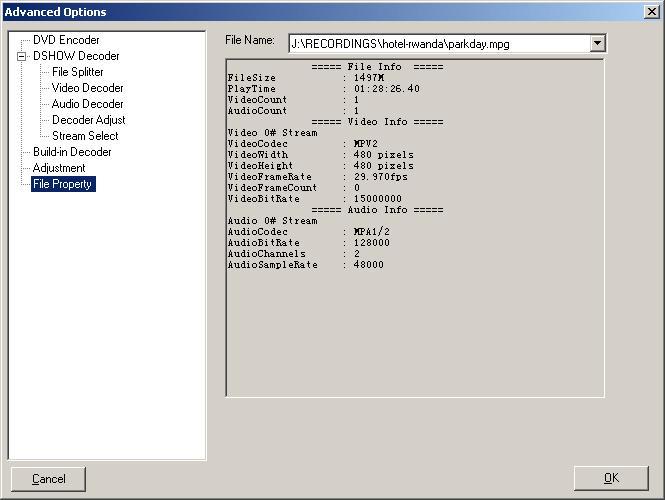

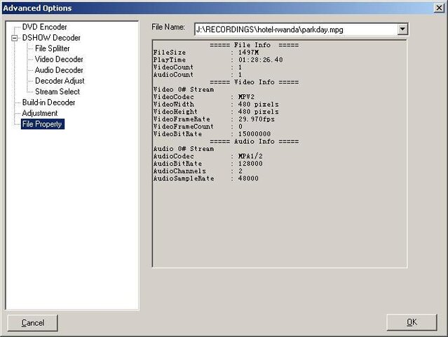

I just reinstalled... hit the dvd button, and open up the mpg file. The movie was recorded off of wgmu on g10r. DVD is selected in the pull down as default. I click advanced. Switched to Lower Quality in Output settings second pulldown... changed split setting to 1013 - sorry, there's no check box, just a pull down that you can type numbers in to... also no constant video size box to uncheck... the first box above Lower Quality pulldown is a pulldown with options as Constant Output Quality, Constant Output file size, and Constant quality by max bitrate. The default is Constant Output Quality. I left it at that....
I don't see a detail tab. There is a File Property Tab... it's showing this on the first mpg file:
===== File Info =====
FileSize : 1497M
PlayTime : 01:28:26.40
VideoCount : 1
AudioCount : 1
===== Video Info =====
Video 0# Stream
VideoCodec : MPV2
VideoWidth : 480 pixels
VideoHeight : 480 pixels
VideoFrameRate : 29.970fps
VideoFrameCount : 0
VideoBitRate : 15000000
===== Audio Info =====
Audio 0# Stream
AudioCodec : MPA1/2
AudioBitRate : 128000
AudioChannels : 2
AudioSampleRate : 48000
and this on the second:
FileSize : 1520M
PlayTime : 01:24:17.472
VideoCount : 1
AudioCount : 1
Video 0# Stream
VideoCodec : MPV2
VideoFrameCount : 0
Audio 0# Stream
AudioCodec : MPA1/2
AudioChannels : 2

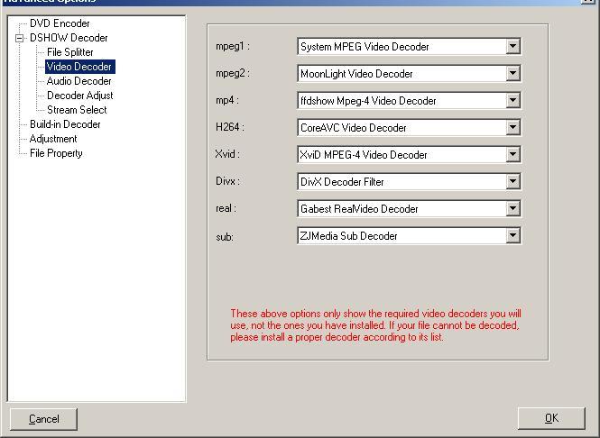

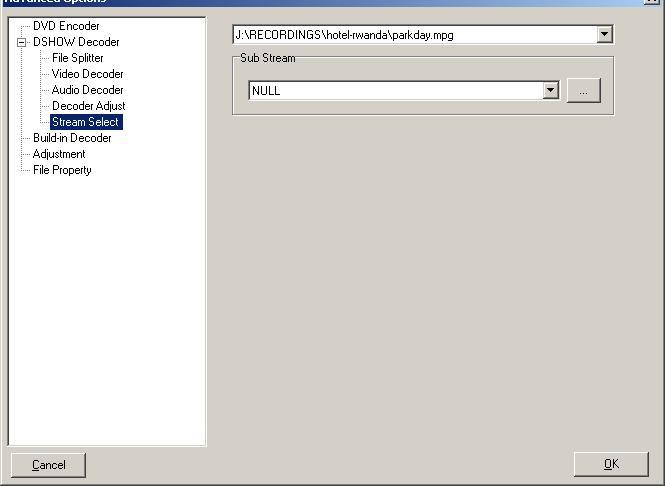

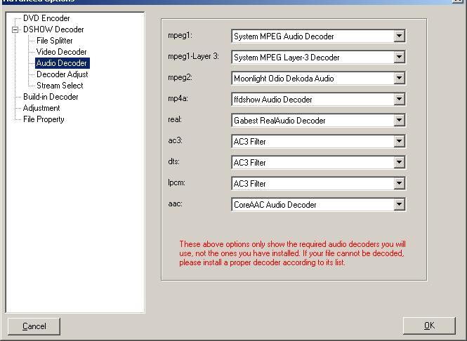

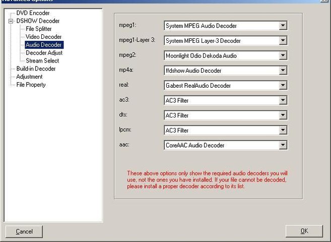

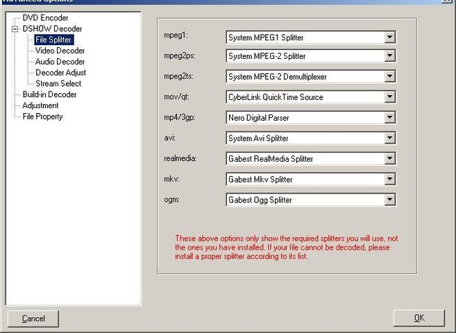

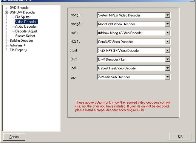

Here's some screen prints... taken before I changed stuff in the advanced options too much.. I think we may have different versions of the program since you are seeing some different options to check than I am... I'm using winavi video converter version 8.0.
When I open up nextorm and tune in to wgmu the green text that shows up a few seconds on screen indicates that it's 480x480, 29 FS... but I don't know if that applies to just the screen I'm looking at or to the actual recording that nextorm uses. I don't think there's ways to change options in the nextorm encoder, or if there is, I haven't figured out how to do it yet. I think it's recording at that same size and framerate and womble isn't messing with it since winavi is showing in properties
Video 0# Stream
VideoCodec : MPV2
VideoFrameCount : 0
Audio 0# Stream
AudioCodec : MPA1/2
AudioChannels : 2
Changing the audio settings in DVD Encoder tab to Autio Bitrate of 128000 doesn't seem to help. You'd think that matching it to the audiobitrate of the source mpg file would help, but it's not for some reason.
