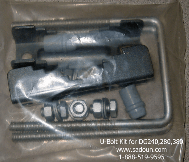

Yes there are ubolt and clamps but for some reason when they are tighten down the pole is still to slick for the clamps to bite down so when the motor moves east to west it's sliding out of position
Never had a problem like that. I snug up the bolts when aligning the motor on the pole. Then when all is tweaked I torque down the nuts being carefull not to over torque the nuts which could cause the pole to deform and go out of plumb.
These are the clamps that are not gripping right so I need to add grip or something to keep them from moving
Same brackets on my 380 and never had them slip. But they are on an official Primestar install-pole, which is painted and fairly thick too. Throw a big muffler clamp below the bracket and tighten that down, it won't go anywhere then.

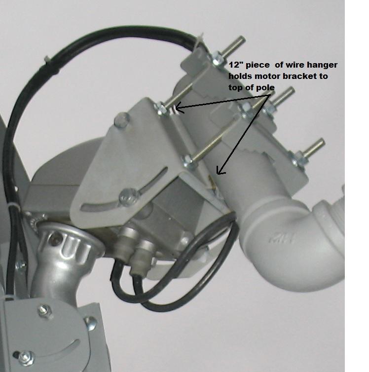

I've always used a fence post gate hinge. The hinge post keeps the motor from sliding down while holding the motor bracket in place for azimuth adjustment.
