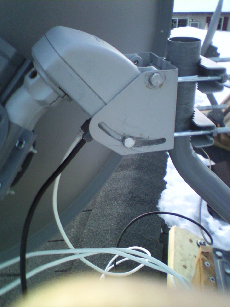

I'm considering buying a new dish so I can pick up other birds and have a couple of questions as to what are the best options for me. I now have a 31" winegard and 2 SG2100 digipower motors with a viewsat pro receiver and a disect switch that is capable of 4 ports. I really wanted to pull in Galaxy 17 for Sioux hockey games but can't get a strong enough signal. I also enjoy the satellite 10R and would also like to pick up a Russian bird for possibly more hockey. The motors that I have only pick up a couple of satellites if they are right next to each other wise I have to go up on the roof and re-adjust. The mounting pole is plumb in both directions, I have latitude of 45.3 and a longitude of --93.8 for Becker, MN. Maybe the pole is crushed or something else but the motor moves real slow when it's below zero in the Winter. The questions are: 1. How big of a dish do you think I can get away with for this motor (the stats say 1.2m). If bigger is
better should I go with the Max?. 2 Could I go with a stationary dish with multiple LNB's? 3 If I did that can I still move the dish to hit other birds?. 4With multiple LNBs is it possible to get 10R at 123W and say Rainbow1 at the other end of the Clark Belt at 61.5W without moving it? 5With two motors what would be my best option? Attatched are pictures of my dish to see if I have it set up right. Thanks for the help-Have a Happy New Year!

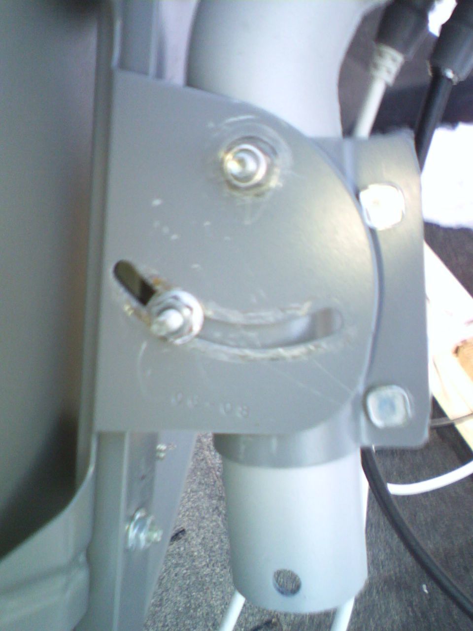

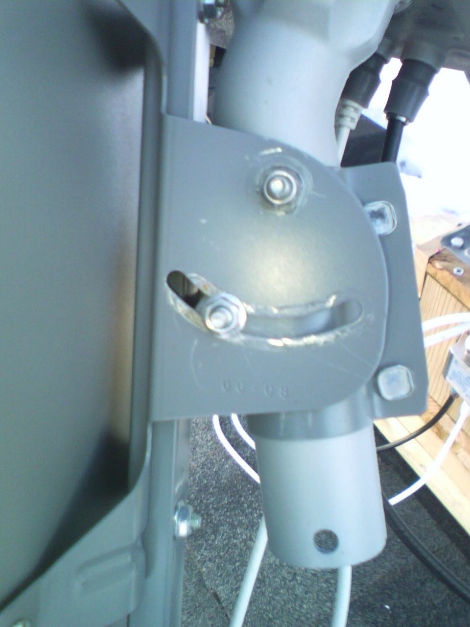

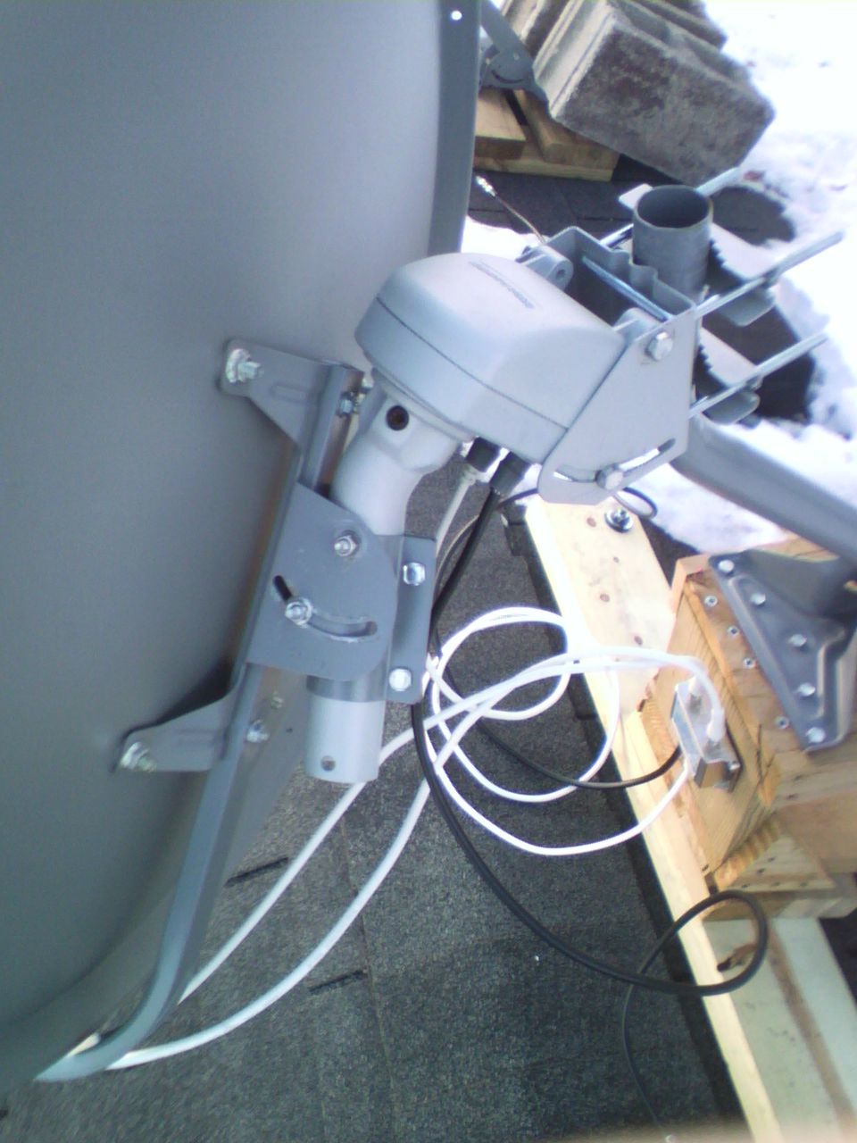

I would say the motor/dish combinations are not properly aligned.

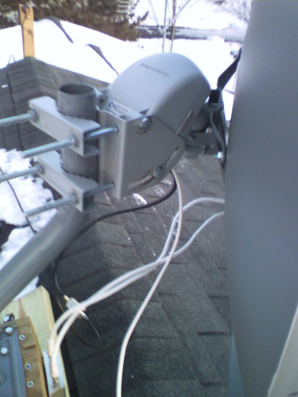

I would try putting a motor on a short ground-mounted pole to get more tuning experience.
Have my doubts the top of your pole is really plumb.
And, if you use that J-pole, I'd turn it around and mount it with the long leg up.
It also needs side support struts. Some dishes come with 'em , but you could fashion your own.
Some people mount close to a wall or post, and use a turnbuckle from the top of their pole to the wall behind to level the pole after hanging the heavy motor and dish on it.
All that off-center weight has got to have a negative affect on the plumbness of the mast.
when you move between satellites pick a H transponder. Then the receiver sends 18volts to the motor and it moves faster. My SG2100 has been mounted since 04 and still runs like a champ :)

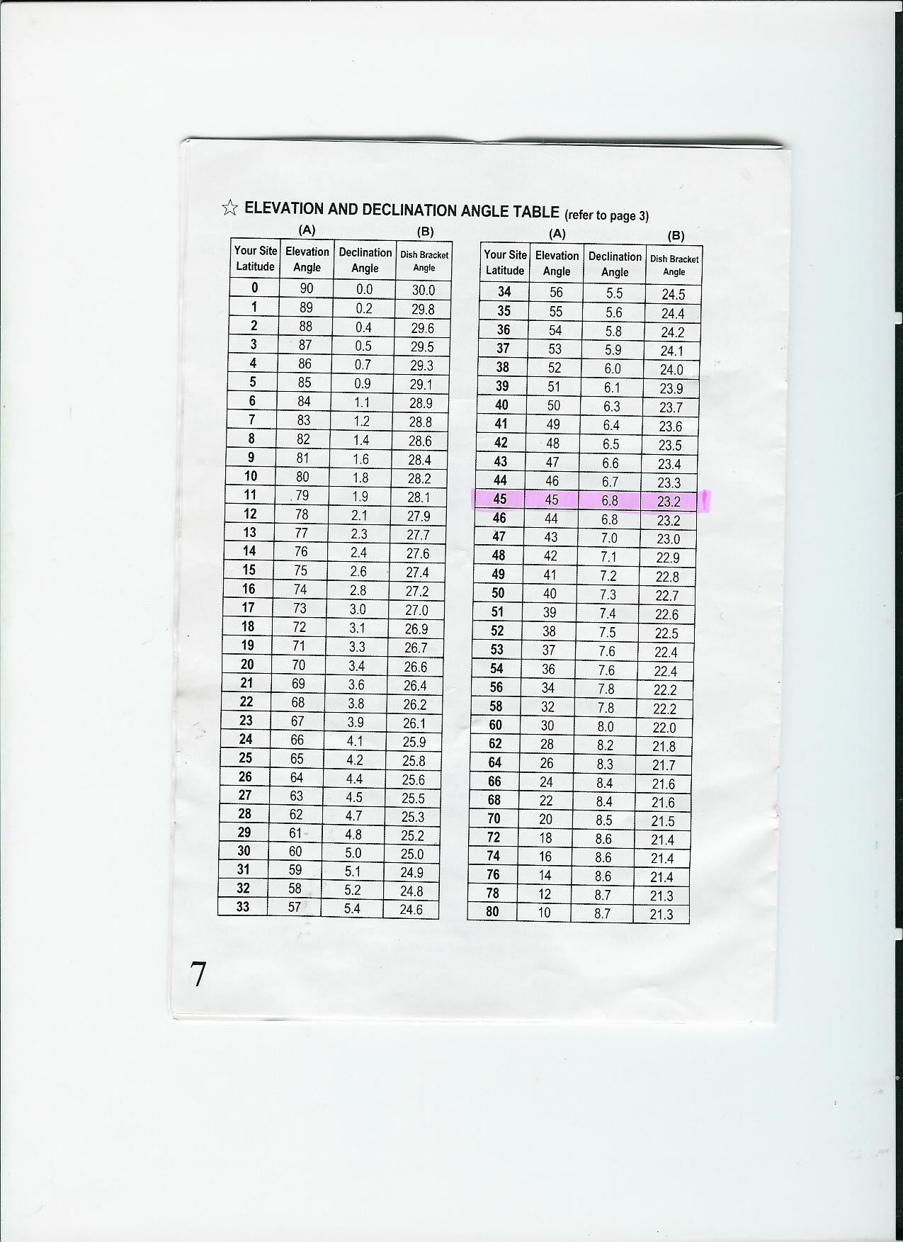

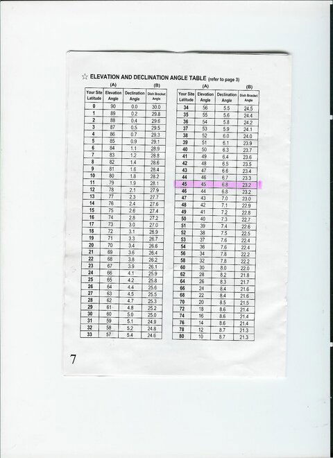

Best thing to do is when it gets warmer is start from true south and go from there....sounds like the dish is out of whack just a little bit. But as noted 91W is just 2 degrees off your true south so you should be able to get that with no issues.
I would zero the motor and reset it (with the pinhole). Since you are .8 off true south (93.8) set up USALS as 93.8 and motor to 93 then repeak the dish. THe last pic is right
motor at 45...leave it once you set at 45
dish at 23-24 but you may have to tweak that
