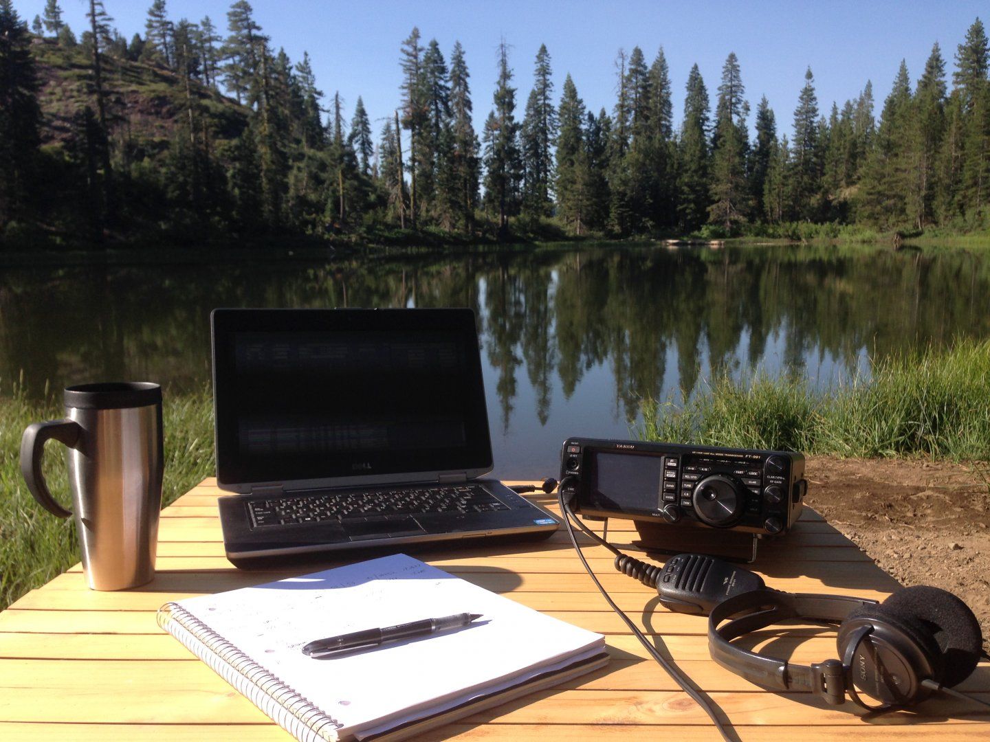

Yaesu 991 Portable

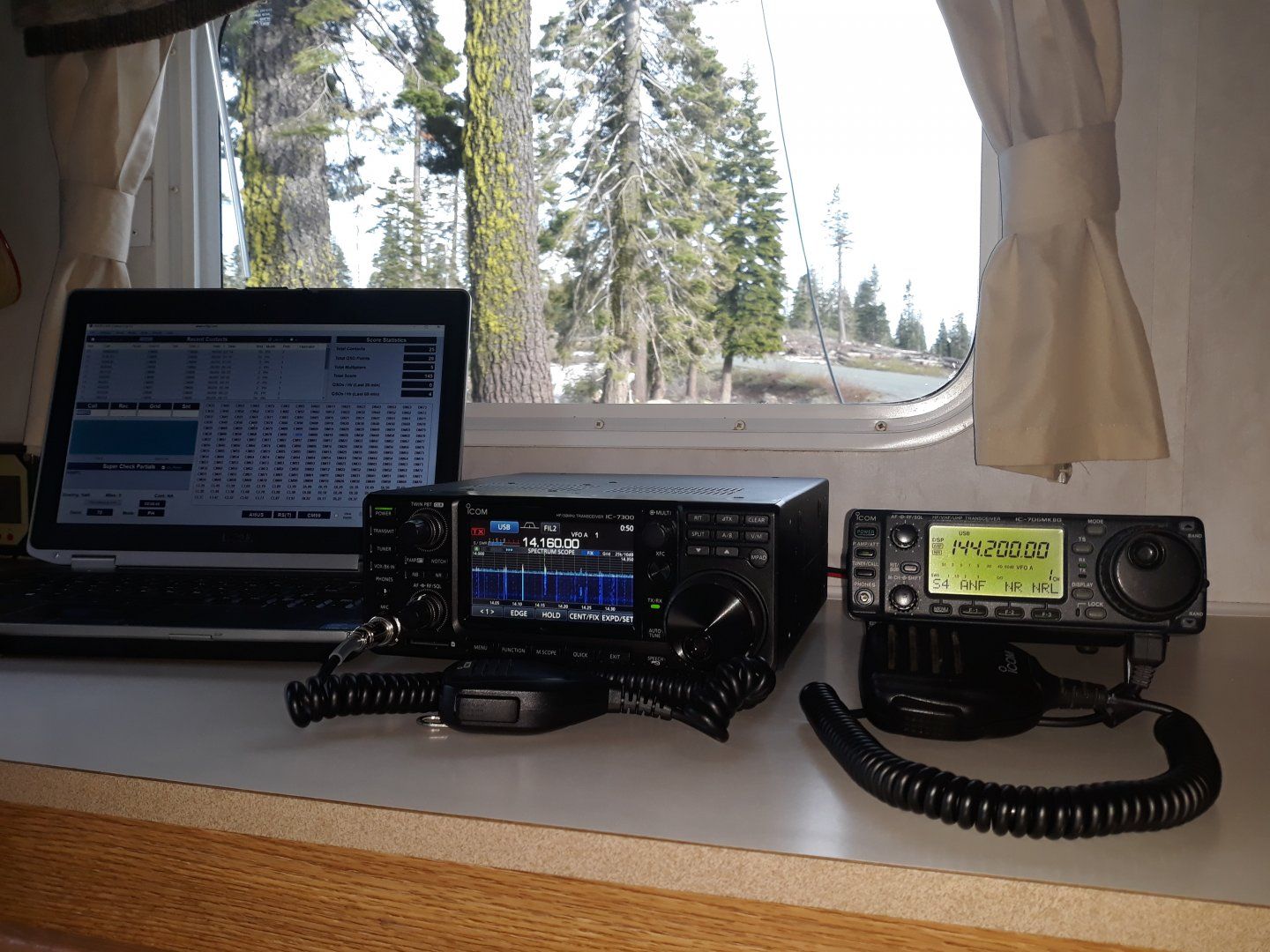

Icom 7300 RV Portable

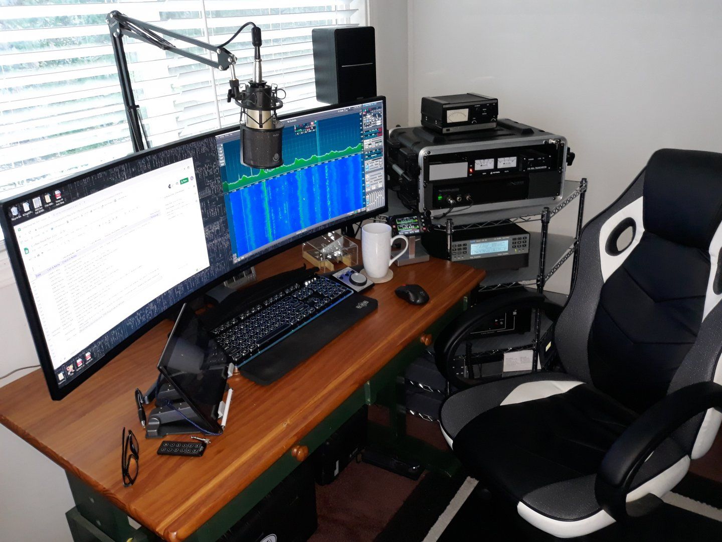

Flex 6300 / SBE Expert 1.3 FA / PalStar HF-Auto

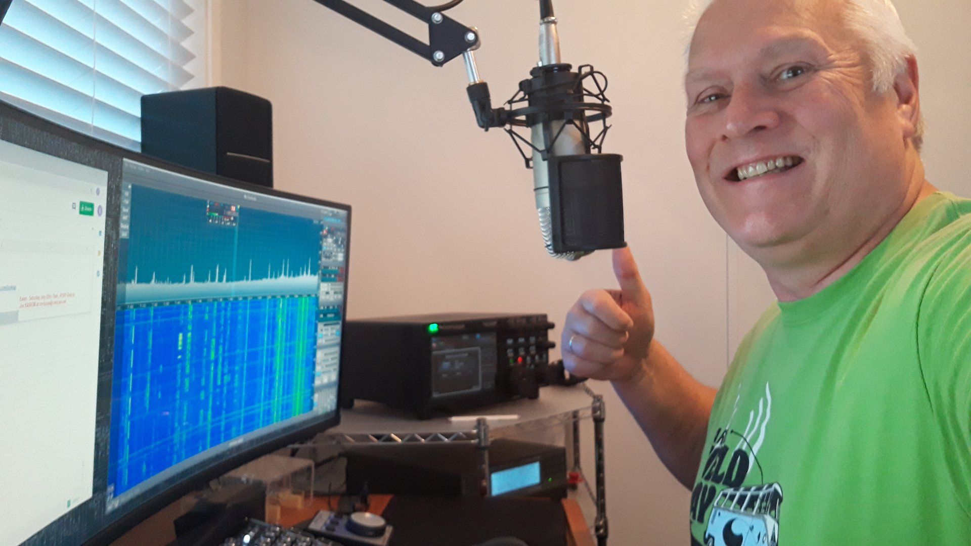

Flex 6400M During FD 2020
