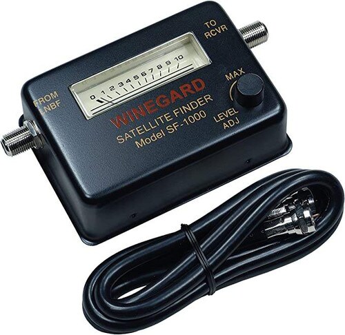

Another disadvantage is that the dish is at one end of the house, mounted just below the roof (ladder accessible only), and the receiver's close to the other end of the house. I also don't have a small TV to use to create a temp hookup of the TV & receiver out at the dish. I do have one of these guys:
... but I've never used it because, as I understand it, these meters are largely useless for most purposes. However, since I have the dish already aimed at the 103W satellite, I'm wondering if it might help me tweak the aim. Or is it pretty much useless for that as well?
I'd love to have one of those fancy meters that runs several-100 bucks, but having less than $200-total invested already between my Orby dish and my Amiko HD 265 receiver, getting a fancy-shmancy meter seems like overkill for a one-time single-dish aiming operation.
Richard
You don't need a sat meter. Most of us have a computer or spare smartphone with camera, wifi and our main smartphone. Bring up your receiver's signal meter on your TV, aim a computer or smartphone camera at the TV screen, start Real VNC or similar program on the computer and your camera, receive the Real VNC signal via wifi at your dish using the Real VNC free downloadable app. You tune your dish while looking at your smartphone.
If you own an Edision receiver, it's even better. You do the above without using Real VNC. You simply connect to your networked Edision via wifi and the Edision app on your smartphone. The latency between the connection of your smartphone and sat receiver is not a problem and you can aim your dish reliably. A TV at the dish is no longer necessary. You can also remotely change selected transponder or satellite using this method.
Reactions: N5XZS
