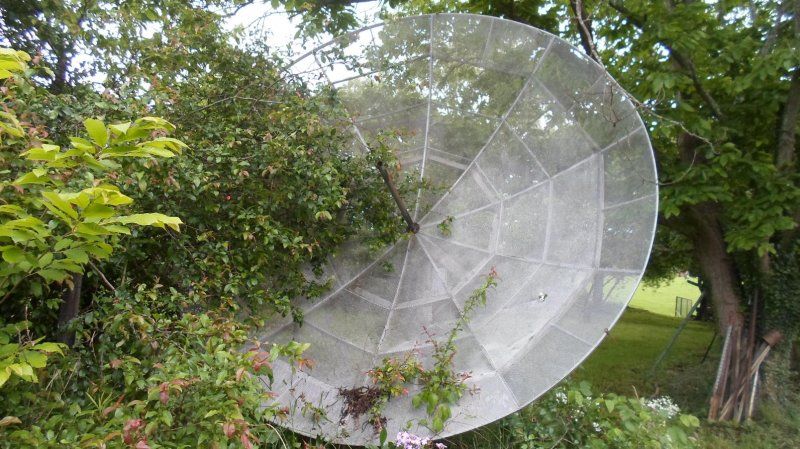

And this 12ft beast that has not been remounted yet:
I like how support arms make a parabolic more rigid. My 10ft Unimesh perf with leg supports does NOT dance in a strong wind like the CM button hook. ( I'm sure being a perf makes the UM more rigid as well)
The 12 footer had lots of flex when I checked it at the original owners site. Well.... after I removed the brush growing over and thru it. :rolleyes:
If I ever mount the 12ft dish... I may fashion support arms to a collar.Let the 'hook pass thru the collar. I like the idea of being able to adjust FD and skew from the back of the dish.
