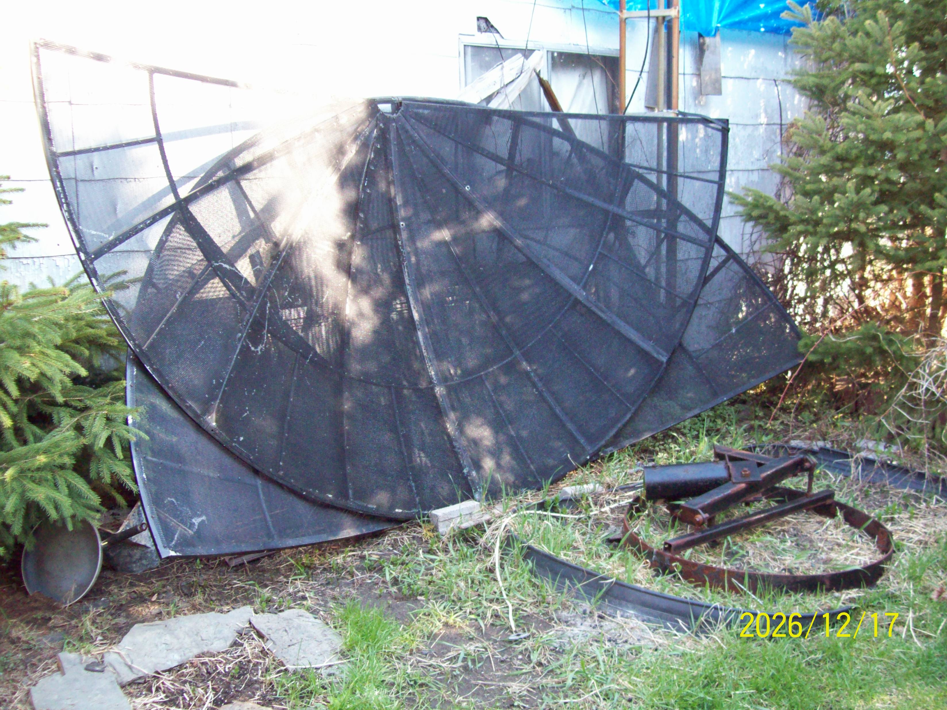

on the 1st dish picture (the good looking dish with all the panels) is that a 12ft orbitron?

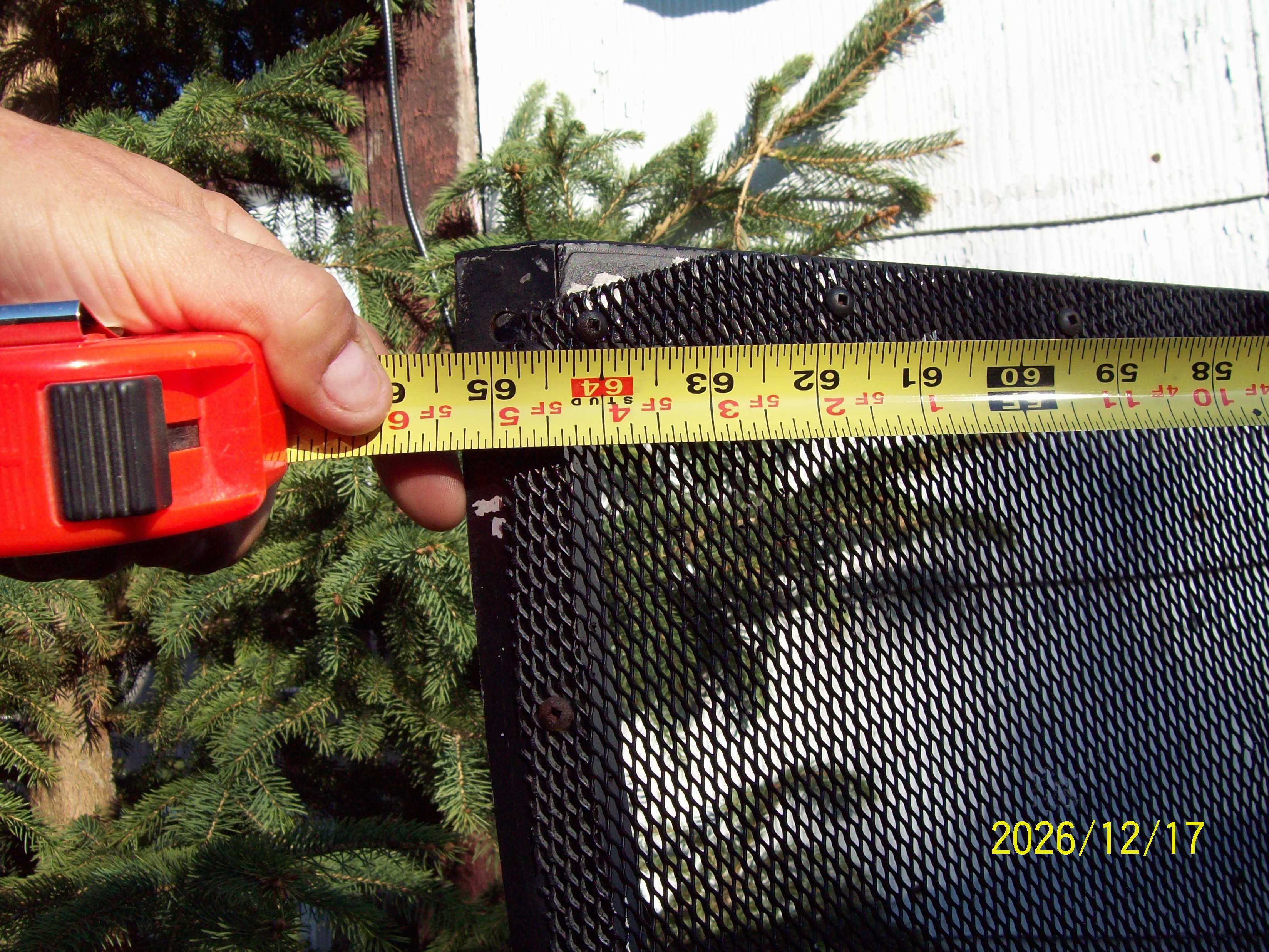

Hi 1captain, I have the dish at home and I'm still not sure what it is? Shown is the measurement from the center (minus about 3-4" as I was by myself and had to hook the tape to the inner circle).

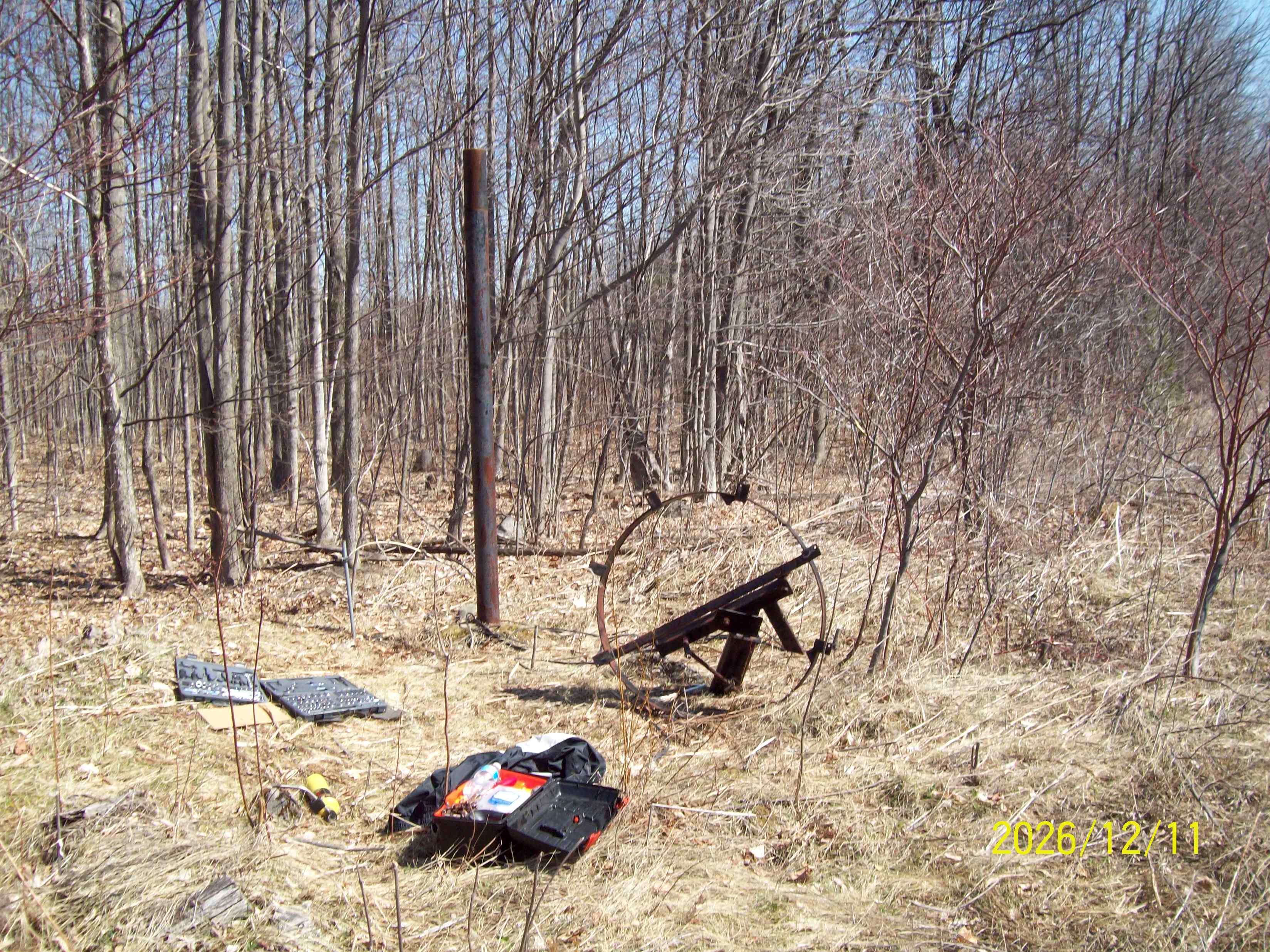

I'm in the planning stages to start digging as the frost is now gone. I'm planning on getting a 15' pole. It will be installed at the right front corner of the garden shown in the second pic, right in front of the metal ring. I would need some advise or pointers at this point as to how deep and how big of a pad I should have? Any help would be greatly appreciated. Marc.
Rule of Thumb is 1 - 60# bag per foot of Dish, 12 bags :0
That may be a little much, depends on the ground, soft and sandy, rocky, heavy frost lift.
The deeper the better. Depending on where you are located and Line of Sight, about 6ft above ground will give you about 2ft clearance when at the far East West Sats.
I was thinking of planting a 15' pole, 5' deep in ground in a 2' diameter hole and having 10' above ground in concrete. For the last 2' or so I was thinking of creating a round concrete pad of about 6' in diameter.
I'm in a city enviroment (Cornwall, Ontario. Canada). Winds can reach 100 KMH but not the norm in the Seaway Valley. The soil is hard packed here near the river.
Does this seem to be right? Any advise would be appreciated. Marc.
Reason I suggested only 6' above the ground is for service purpose, adjusting the Feed / LNB and so on.
What is your frost line? You should be below that.
I would not recommend that, the Frost will probably lift it.

Good advise Lak7 and thanks for the link. The pad idea is out! I will do some reading there.
My research indicates the frost line is about 45"-48" deep so 5' will be a must.
In the Pic attached, I can see the grounding rod is about 4' away from the pole, and this dish was out in a field. (Why would he have put a 2' deep ground rod in when the main pole is planted deeper???) So it seems like 5' deep X 4' diameter should work. I will do some math to see if 11-12 bags of concrete will fit in that size of a hole.

I must be sick, but spotted other dishes that seem to be in better shape. One seems smaller. Still don't know what the heck I'm going stick on the pole. Bigger seems to pull me for KU/C band but thinking??? Ideas??
Thinking about a 6' Dish
