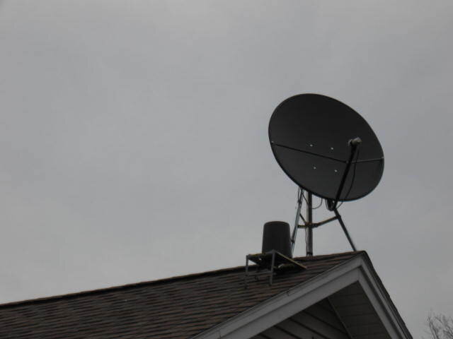

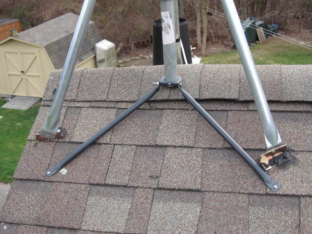

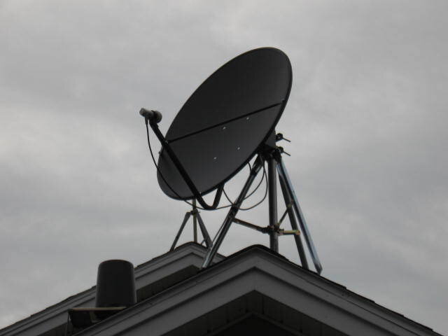

Well here is another update!My satellite is now installed on the roof,got coax running into the home!now i just need my satellite receiver (sat hawk prv 800)which is out of stock right now!hoping sadoun gets his next shipment later this week.At first i had the mast and dish too high causing some play in the wind,made changes today (note extra support i added on bottom of mask).elevations all set and disk is pointing due true south!Guess i will find out how close i set it all up when i get the receiver.Here are a few pics.

Thanks DC for that story and advice!.I used 1.5" heavy duty hex wood screws to secure the tripod.bolts and nut would of been a challenge for me due to no floor on the garage rafter and with the high roof a very hard time getting to the bolts inside.Hope this will do the job!Had some fairly gusty winds today (25-35 mph) and the mast didnt move.The one thing i did notice during wind gusts was a small vibration side to side on the dish.This is not the mast!its a slightly loose motor shaft going into the motor.The motor i have is a DG280 and have read in the booklet that an adjustment can be made for this.I dont want to play with the adjustment unless i need too.Since is my first attempt with a satellite system i dont really know what to expect during windy conditions.Now i just need to wait for my SatHawk receiver that i ordered from Sadoun to come in and get shipped to me so i can make any adjustments needed to start catching some satellites and watching RTV which i really enjoy.
Hi StanleyJohn and the group, I had a few more thoughts on the tripod mounting. It might have been possible to hit the rafters with extra long lag bolts; however, for this to work the span between the legs of the tripod would have to match the spacing of the rafters. For example if the rafter spacing is 16 inches and the span between two of the legs on the tripod was 32 inches it might work. I would not worry about it now. Looks like you have a nice sturdy mount that should last for years. Maybe go up and check it from time to time and make sure the bolts are not working loose. I hope your receiver comes in soon so you can start enjoying FTA. Got to run, DC
