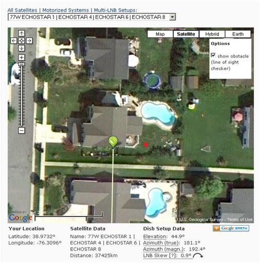

I just purchased a 6' BUD from Fridge and working to determine how far away from my house I should place my pole for mounting. I'd like to get as close as possible without hitting the house while maintaining a good arc. I've got a relatively good view of the southern sky from about 30W to 139W. My southern sat is Echostar-1 at 77W with an el of roughly 42 deg. I plan to mount the dish at ~4 feet off the ground.My question is how far away and or/ close should I be from the house to maintain a safe distance and capture a good portion of the available arc?

Alot of that depends on which side of the house you are wanting to mount it... On the south side there should be no worries. On the north side, well that could pose a problem. Please be a little more specific and is there any way to post a pic of what we are dealing with? Have a great day!
A 6' dish doesn't need as much room as a 10'. But I would allow the room for future expansion. Planting poles can be expensive and kind of permanent. So give yourself 5~6 feet clearance. Make sure you can see over the neighbors house. And make it tall enough for future growth :)

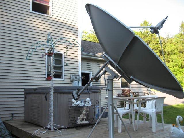

I have mine mounted on a 3 foot mast,3"diameter on my deck which attachés to the house.I prefer it near the house and low to the ground to keep an eye on and for easy maintenance.One other plus having it near the house is that the house blocks out any high winds from the direction of the house,Hers a pic of mine.Update!! After seeing the pic you posted you may need to put the dish higher if you plant it on the south side of the house due to line of site clearance from house to the south.

She suggests to put it in the back yard with the cement pond mainly due to
the side yard does not look all that big and it would obstruct your house.
I think this would also solve the possible problem of clearing the neighbors house!!! ;)
You might want to be a little concerned about the house to the southeast of you that has the big tree, depending how far north/south you live that tree might be an issue even if you are near the height of the arc.
After reveiwing the pic! it looks like you would be ok to put the dish close to the house on the south side if the house to the south is less then aprox 35 feet tall.PS Good spot Stone!!

Thanks for more photos!
I did not see the ku dishes in your first photo so you already have a dish garden there!
There are no windows on your house near the BUDettes so a 6' would not really block
anything. The distance to the fence looks ample too for the BUD. As long as you have a
good LOS and the neighbors house does not interfere then plant it there! :)

Taking a few measurements with both tape and angle finder it looks like the spot in the side of the house will work. The only thing that needs to get by is my push behind lawn mower.

Pole went into the ground tonight 36" from the house with a little over 3' in the ground and 4' above.
