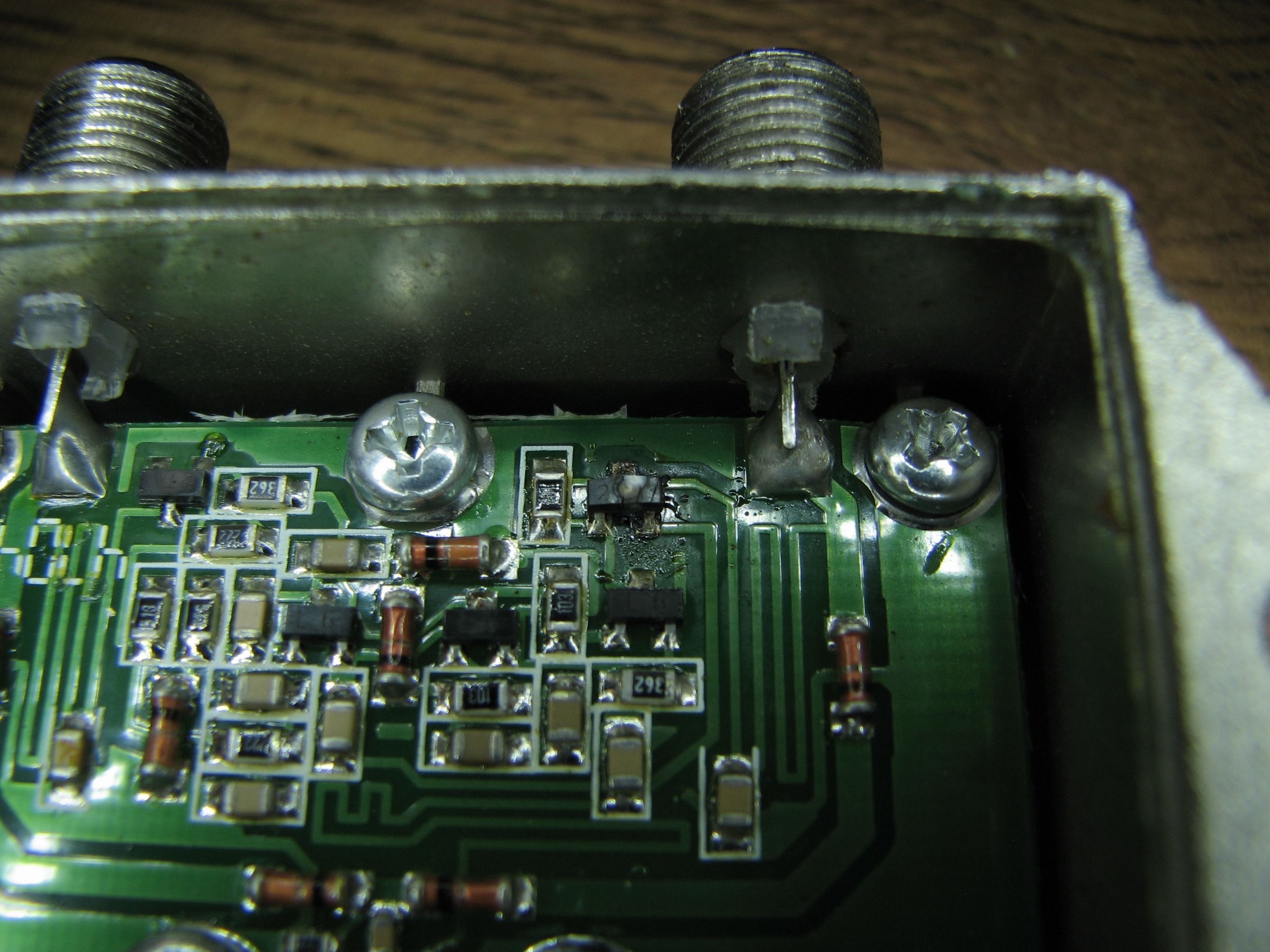

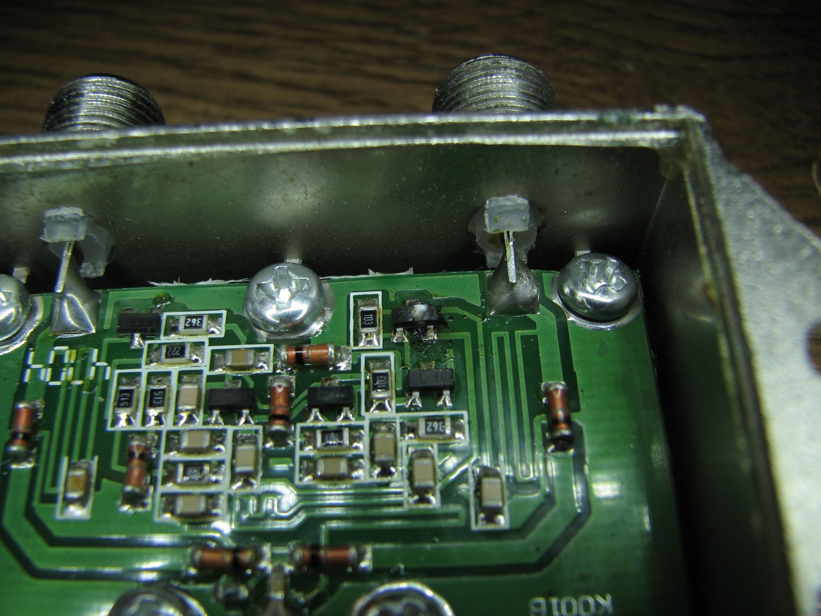

When I brought that bad 22khz switch in the house the other day I tossed it on my desk and forgot about it. But all day today I kept smelling something BAD..
After awhile it began to really get on my nerves so I started trying to find it. It is that very distinct smell of burnt electronics.
I was freaking out thinking my computer was burning up or a display or something.. But I found it, it was the switch.
I popped the back off of it to see what was in it and I could see a little black thing that looks brunt and popped open.
One of these things is not like the others. As they say..
As cheap as it is to replace it I can't imagine wasting the time, effort or money to fix it. But at least I know for certain now what the problem was..

That's a surface mount transistor. Must have taken a jolt of electricity somehow to pop it. Did you hook it up with the power on, or anything like that?
Either way, it probably saved the rest of your system from being fried by basically acting like a fuse.
As far as I know I haven't done any disconnecting or connecting with power on. I always shut down the tuner properly then pull the power cord from it so they entire system is cold and dead before I mess with stuff.
I just assumed it was your standard cheap Chinese garbage living up to it's well known reputation.
Built up static electricity can easily destroy any eclectronic switch even when all the power is removed. The worst are the cheap disq switches that are provided free with the purchase of the receiver.
The last time I saw a component damaged in that manner it was caused by lightning. The inside of the LNBF and the cable connectors looked like that. The buried cable survived and is still in use today even though it's 26 years old.

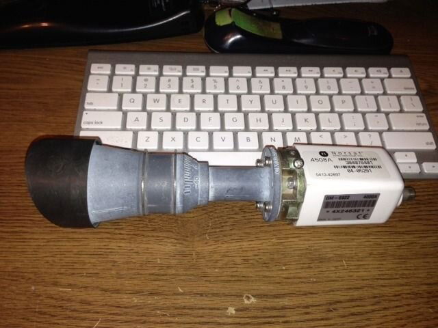

In my digging around in my junk box I found a weird little LNB that is single polarity. It came off of a Muzack dish my dad bought when a local lumbar store went out of business.
It's a Norsat 4508A. I googled it and it says it's a DRO type. Again, this is something I know nothing about.
Here's the info I found on it, http://www.satcom.com/norsat-4508a-band-p-224.html
?What I was thinking of doing is putting up a separate dish just for 83w exclusively with this LNB on it and since it's horizontal only that I'm interested in (RTV/PBJ) I could feed the output to a 3x4 so I could supply several tuners and not worry about getting it via the motorized dish which is a tad unreliable.
Yes no?

Your Norsat will certainly do what you want.
There is a little adapter disc maybe 1/4" thick and the size of a half dollar used to mate it to your existing feedhorn.
Assuming you are on a Primestar/ChannelMaster/Andrew dish. :up

Yes, that feedhorn & LNB have the adapter disc between 'em; you are good to go.
