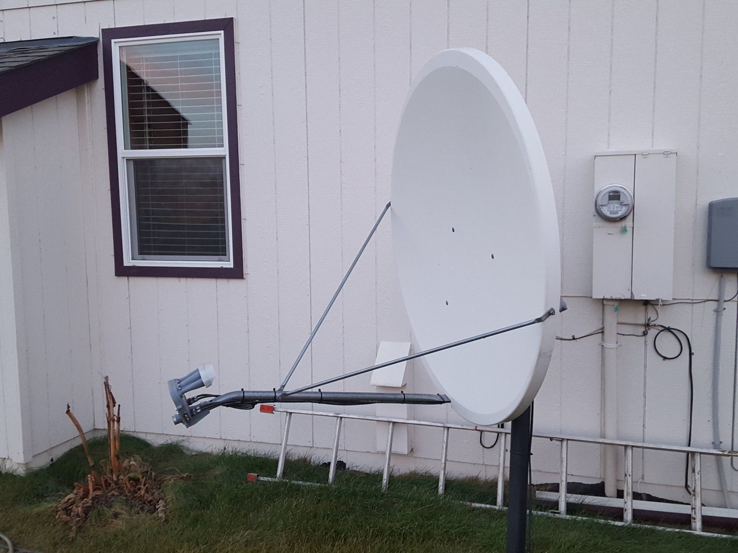

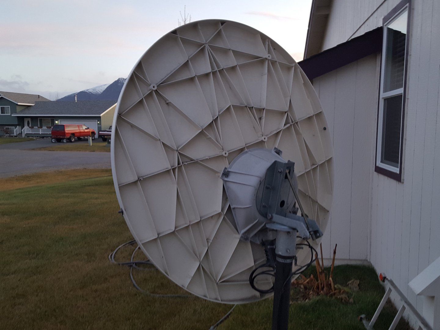

Check this 1.2 meter dish out, it is at my house this is what DirecTV installs in Alaska and Hawaii. Pretty sure it is made by Prodelin real similar to the General Dynamics Prodelin "High Wind" dish they offer, Ku and Ka of course. Built in adjustable skew mount. No fading from precipitation, many signal readings of 100 or in the 90's here in the Anchorage area.

Nice dish!

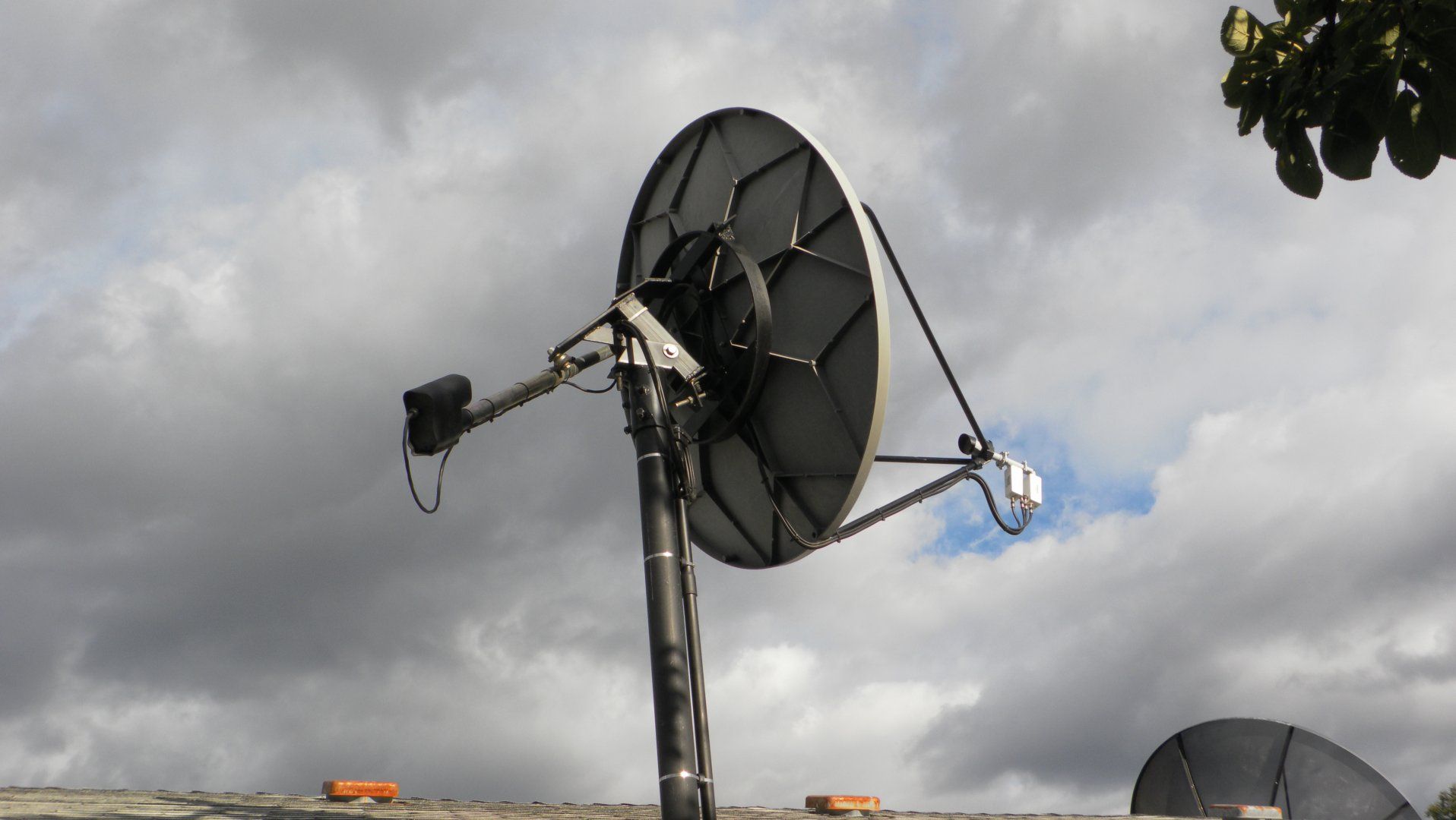

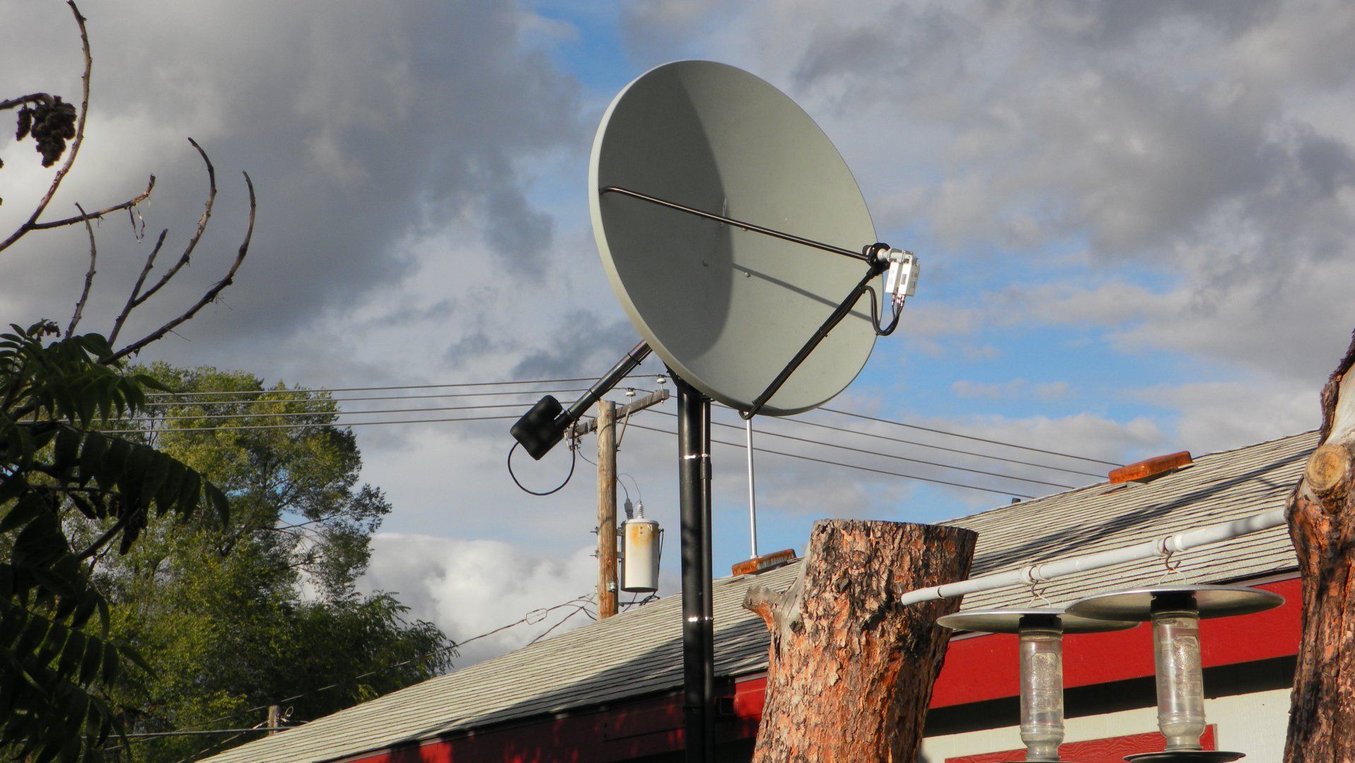

I've been fortunate to have access to more dishes and all their parts than most folks. There are free dishes still out there. :) My 1.2M CM dish started as a PrimeStar DTH dish. Now that credit card point of sale devices use the internet predominately, the satellite systems are just thrown away or left ignored on top of the building. Many quality Ku dishes unused out there.
? offset angle Primestar 1.2m

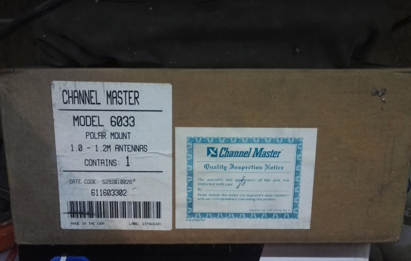

To some extent it does come down to whether or not you intend to motorize the dish. Buying a good quality consumer grade dish like a GeoSatPro will lend itself easily to motorizing and give a solid experience, whereas a commercial dish is going to be more difficult to find the parts necessary to motorize. All of the gas station/car dealership and hotel systems out there that I've seen are static mounts. If you find one with a polar mount you'll have the best of the best, but more likely you'll either have to fabricate the mount or get a quality steel dish and a STAB motor.

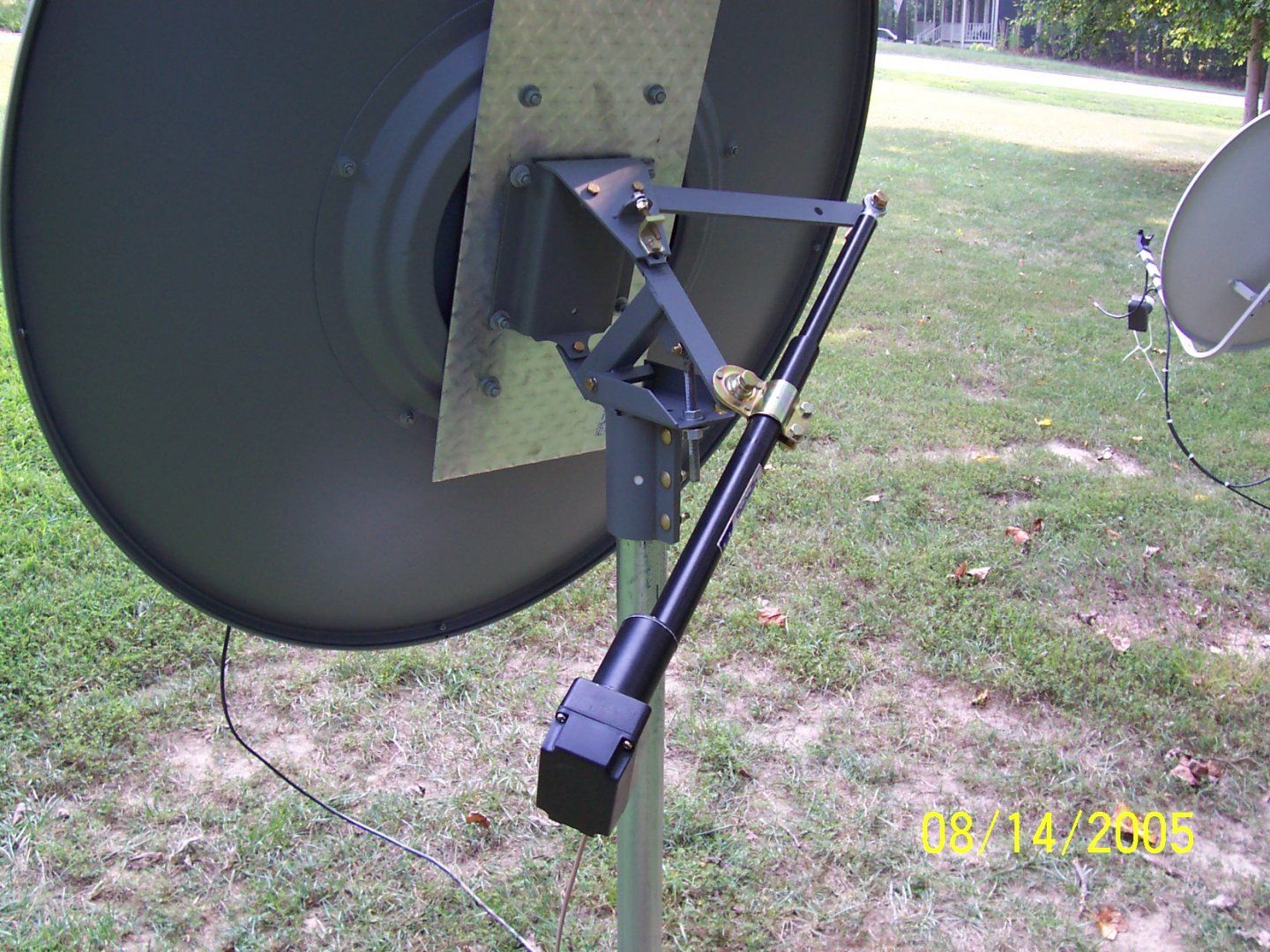

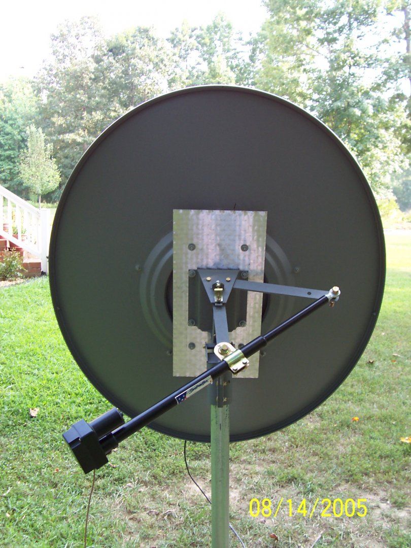

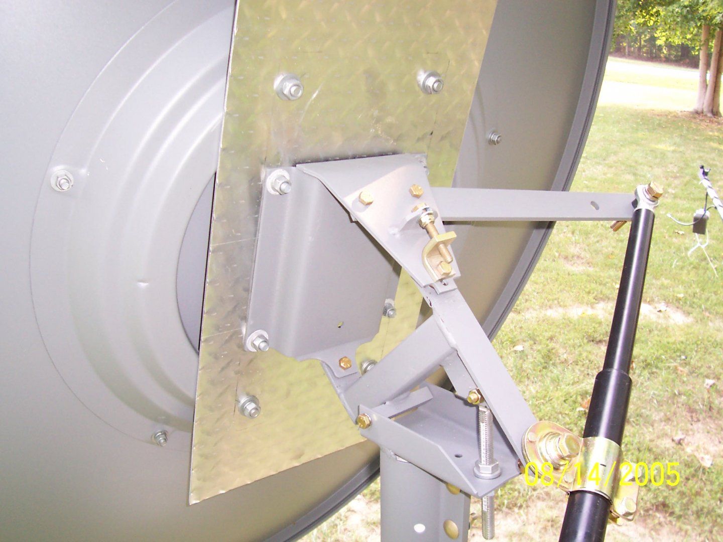

Years ago polar mounts were available for a reasonable price...I retrofit one on a Patriot 1.2 meter dish and it worked out nicely. However these days I don't think you can find them.
