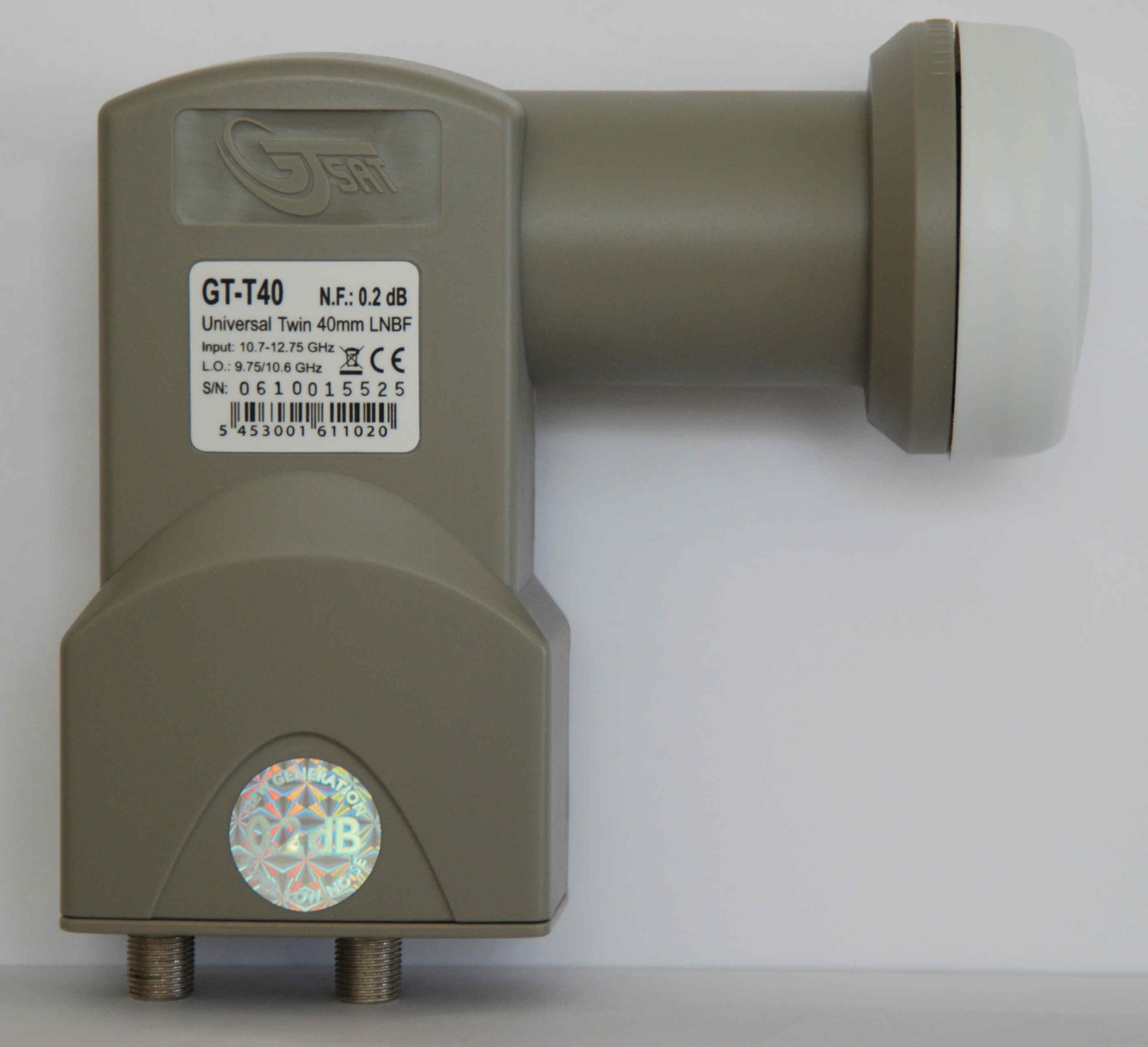

Just came accross also the very economically priced GT-SAT GT-T40 dual LNBF.
The specs are even looks better than the two previously mentioned!
(Low Noise figure 0.2 dB, and high gain 56...60db !)
Anybody has tried this out ?
Thanks!
