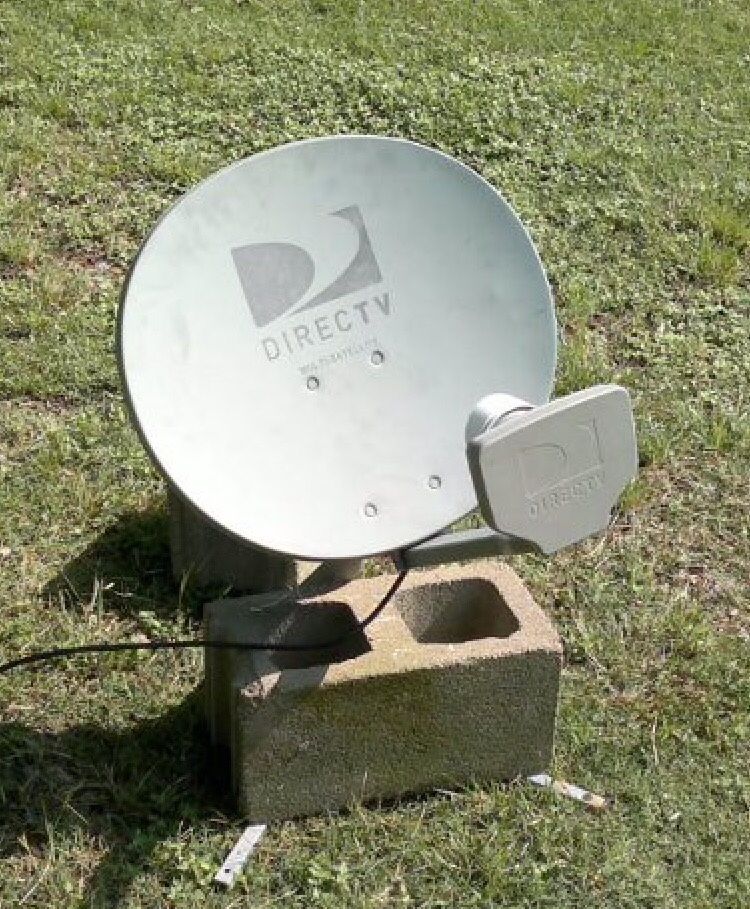

I have been a Dtv client for more than 20 years. Part of the reason for my long term commitment is that my family enjoys camping and I could easily carry one of our receivers to the camper and we could enjoy all of our programs while we are at the lake. A few years ago a Dtv rep told me I no longer had that option and kind of forced me out of the set up. I was recently talking to a different rep that sent me another receiver to try again. He said that he saw no reason that it would not work. Here's my delema. The dish I used back then is out of alignment and I now can't find a satellite. Does anyone know which satellite to use in NE Alabama? I have a satellite finder but I have no idea which satellite to look for! Thanks for the help.
Register to hide this ad
If its Standard Def, it's the 101 satellite
If it's HD its the 101,103 and 99 satellites.
Going by the city listed in your profile, the 101 satellite is as follows:
Elevation: 46.4
Azimuth: 207.4

Thanks everyone! I was able to get it with the Elevation and Azimuth and a few tweeks to my system. I love having the system at my camper and hope they don't change stuff so we can't carry our programming with us when we travel.
Your always able to as long as you have the correct dish.
