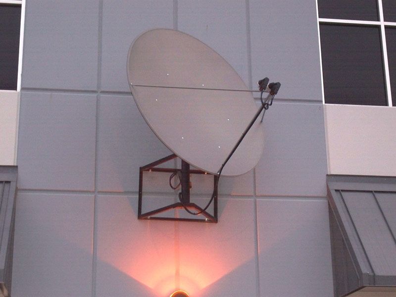

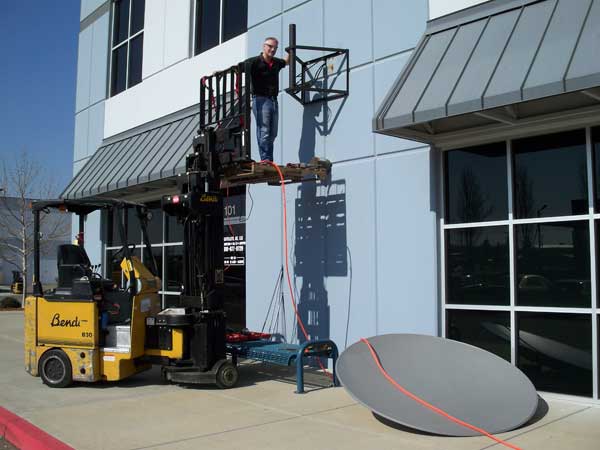

In a few months we will be offering a GEOSATpro 1.8M Offset with polar mount and locking bar to be used for fixed installations. Final retail cost is not established, but it will be considerably less expensive than the brands listed. :D
Stay tuned for more information as the release date gets closer.
Mosters to hang and monsters to ship!

Nice lookin' dish, Brian. - :up
Shipping a 6' solid is going to be a challenge, though.
What's the f/d gonna be?

I want one on the side of my house:)
I'm guessing that dish is to big/heavy to go UPS or FedEx package, will it have to be shipped LTL freight?
I've had LTL stuff shipped to the carrier's local terminal for pickup at their dock, it's cheaper than home delivery. Plus you can inspect for damage at that point, and if there is a problem, initiate a claim. :(
Maybe Brian can post some more specs (weight?) and pics soon.
