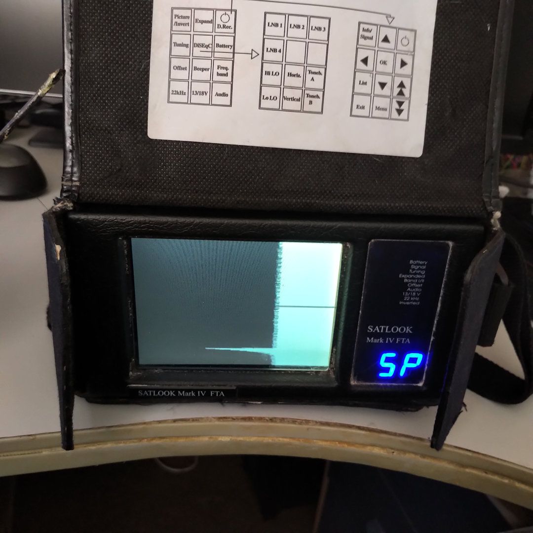

I was about to reset up my corotor this afternoon using my Satlook FTA and find there is zero power coming out of the F connector on the unit . This unit has been fitted with a new battery and the display looks fine but there is NO Power coming out of the F connector on the unit .
I fully understand this unit has is short-circuit protected is there any thing inside the unit that needs resetting ? I have looked for a schematic but there is nothing on the internet except the manual . Any thoughts from any one since this unit is 25 years old it maybe very hard even to find a schematic .
So you turn the unit on and you can see this in the display so there is power . Am I missing some thing as far as I remember you connect the LNB to the sat look and it should show you a signal but without power from the sat look there is nothing .

The output is switchable between 13/18Vdc, but I don't recall an option to disable the LNB power.
Alternately, provide power to the LNB with a STB set on Horizontal (18Vdc) via a power passing splitter (combiner) and read the signal with the Satlook.

Thanks Titanium , Yes this is my thoughts if you press button 8 you can switch from 13v - 18v but your right the f connector is live with power but I am getting zero , Tomorrow I will open it up and see if I can trace were the power has gone but working blind as no drawings .
