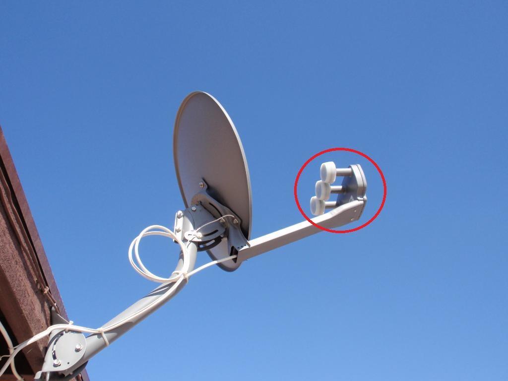

Do you have a receiver deca on the back of the H23? It looks like a little white box with a cat 5 cable coming from it. Also, do you have a blue label splitter and LNB?
Based on that its a great bet you don't have the proper equipment or setup. The service call (assuming they bring the hardware) is your best choice.
The LNB = low-noise block downconverter and it is the "eye" at the end of the dish's arm outside. Your model may vary.

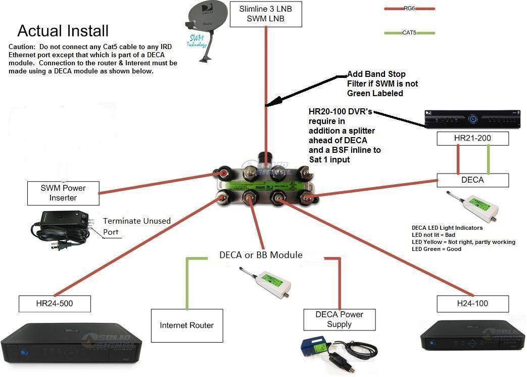

Yes, you will need their kit with your hardware setup. The older setups like mine (sig line below) you can connect to your home network and add the $3 service and you are good to go.
CCK-W (example wiring setup)
Got it. So If I purchase the DECA and power supply and connect it to my switch as long as it has a green label I am good to go for whole home and directv cinema?
With all due respect to charper1, you do NOT have to have your system connected to the internet for Whole Home DVR to work. But, you do have to have the correct setup. If you just follow everything in his diagram except the internet connection part, your whole home will work just fine. That is the way mine is setup currently.
If you want Video on Demand, then you need an internet connection. If you have a wireless router, I would suggest going with D*'s wireless cinema connection kit as the best (and least cost) way to do that. They list it on their site as the "self install" kit. Price is $31 including shipping.
On edit: I just reread your next to last post where you are discussing both MRV and VOD. But, my answer still stands, you do not need an internet connection for MRV.
I though he said (took a leap of faith on what he was trying to say) that he HAD the whole home working but when he wanted to connect to the net (I assumed for VOD, etc) he got disconnected. That's why I went the direction I did.
I though he said he HAD the whole home working but when he wanted to connect to the net (I assumed for VOD, etc) he got disconnected. That why I went the direction I idi.
On yet another review of all the posts, I agree that the language was a bit confusing. The way I read it was that somehow things had gone south on him and he wanted MRV to work. Your picture was spot-on for showing him how to hook things up correctly.
He only addressed VOD quite a bit later. If he has wireless, however, I would still recommend the D* wireless kit, vs the hard-wired DECA.
