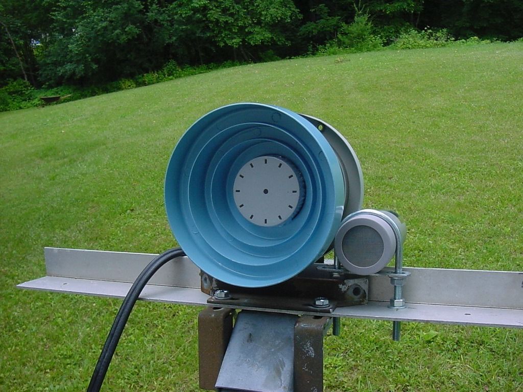

I put a conical scalar on my first 6' Prodelin I put up a few years ago for 4DTV fixed on 105W. It made a pretty big difference with the Motorola receiver on digital. Analog is pretty much watchable with any signal at all, just a few more sparklies in it.
I like this information - - - I assume you used this conical scalar - - - or one similar.
Here's what it looks like when it's uncovered. It's not exactly weatherproof by design since it points slightly upwards. I wish someone would sell a reasonably priced covered C band LNBF for offset dish use.
