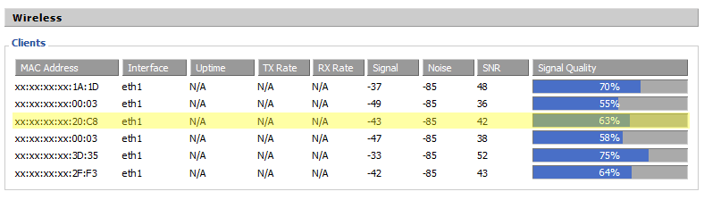

EDIT: Just checked the strength on my wireless Joey. 48-50 strength in the same room. It's pretty much just showing the SNR which is NEVER 100. Anything over 25 is considered good on wireless G and wireless N. You'll be hard pressed to EVER hit much higher than 60 even in the same room. I have two high power directional antennas on my router, here are my signal strengths on various devices (wireless Joey is highlighted.)
The wireless Joey is about 5 feet away from the two high-powered antennas. 1A:1D is my laptop which is also about 5-6 feet away (less obstructions though.) The top 00:03 is a wireless bridge which is about 30 feet away through several walls (and glass.) Bottom 00:03 is about 30 feet away with slightly less walls and no glass. 2F:F3 is a wireless printer about 30 feet away with a good bit of obstructions. 3D:D5 is my Roku which is in the same room as the router. It's the closest device to the antennas.
Again, anything over 25 is considered "very good." The scales are just weird kinda like the Point Dish signal meter.
