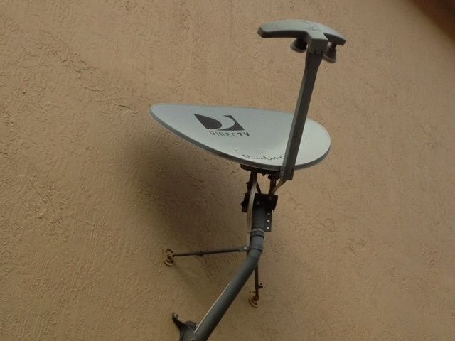

All I know is that I have a slimline dish. No idea what model.

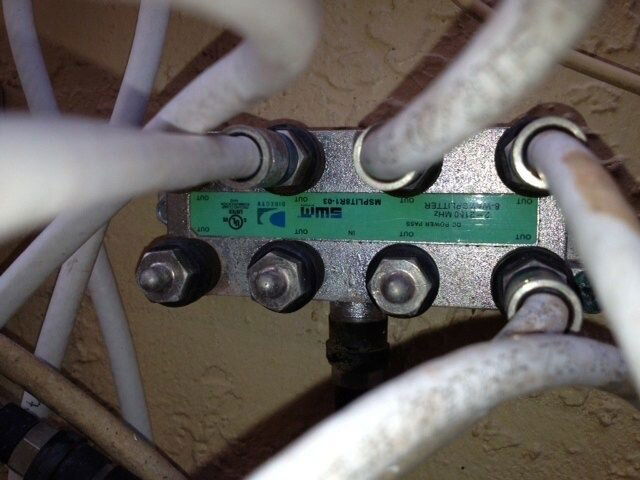

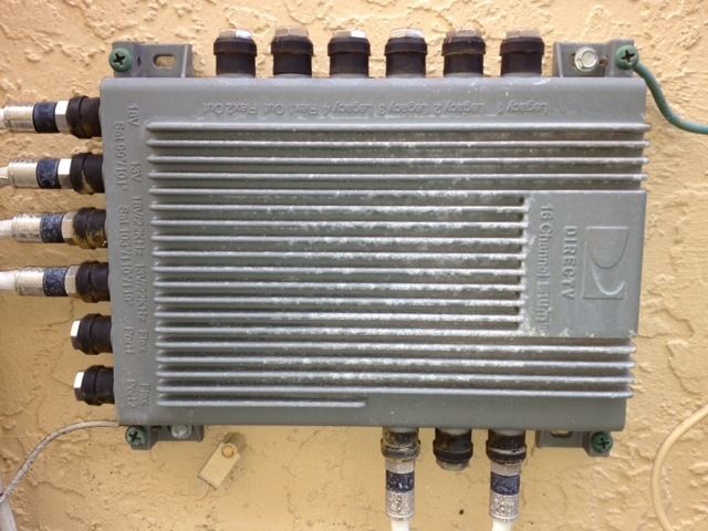

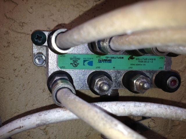

From there, I have what looks to be a 16 channel swm and two 8 way splitters.

My only thought as to why you would get an error saying you had too many receivers on the coax network would be the way the splitters are set up. The 34 does have 5 tuners, so since you can only have 8 per leg of the swm16 it might overload 1 leg if they are not split properly. One thing I see missing is the power inserter on the swm16 ,all I see are the 4 lines in from the dish and 2 lines out to the splitters.

Power inserter is inside the house, plugged in next to the receiver. As for PIP, that is one of the reasons I'm now very interested in the genie. I'd much rather avoid paying the extra cost for an extra receiver six months of the year. Ironically, I happen to have a new Sony tv that has PIP/PAP and that is also one of the RVU-enabled tv's that works with genie. But, my understanding is that the PIP only works if you hook the genie directly up to the tv. No biggie.
