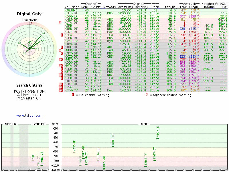

KJRH in Tulsa OKlahoma will move from DT56 to DT8 and reduce power from 1000KW to 18.2. This means I will loose that channel in 2009 as I am located more than 75 miles south. I am in Tulsa DMA and this is a shame. No HD anymore and I will rely completely on a satellite or cable provider to continue watching that channel AND having to pay for it, and other people get it for free. DTV transition is a farce!:mad:

18.2 KW on channel 8 works about the same as 1000 KW on UHF. The only reason for you to loose KJRH in 2009 is if you have installed a UHF only antenna. The tvfool results list the projected strength of KJRH on channel 8 in McAlester, Oklahoma

The only problem is lighting and electric noise plus old cars with bad spark plugs will screw up digital channels on VHF!

According to this, compared to the current receiption scheme, I would have a better signal from KJRH providing I'd add a good VHF antenna to my 91XG and activate the VHF input on my CM7777.
What would be a good VHF only antenna for 75 miles from the towers?
