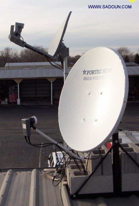

The non-penetrating roof mount will work fine if you have a flat roof. Just be sure to use good, heavy cinder blocks. These mounts generally have a 2 3/8" mounting pole, perfect for the Channel Master dishes or for a motor. I have two such mounts in my dish farm on the shed roof, one with a motorized rig and the other with a 1M Channel Master.
These mounts are available at Sadoun.

If you could describe (or show pictures of) the roof, we could offer better info.
Identify which way is south, if you do.

You should check your roof out first, as it puts a lot of weight on the roof. Choose a place that has adequate support, and you may want to place something down first to both prevent damage to the top surface of the roof and prvent it from shifting on the roof. If more weight is needed, the cinder blocks can be filled with concrete to add weight. Be sure to use a pole high enough to make it useable, but not too extreme as it will act as a lever when the wind blows. i.e. does not need to be 10 ft above the roof
I personally use four 4 x 8 x 16" SOLID blocks, one at each corner. My NPRMs stayed up there through Hurricane Katrina (with no dish reflectors on them, of course) without moving at all :)
