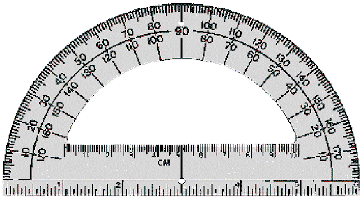

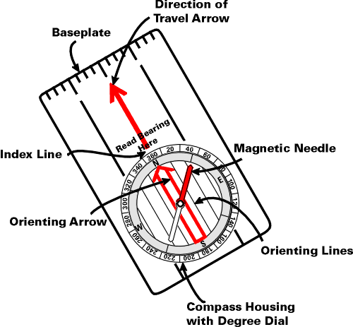

You can also use a $12 compass from wal-mart or hunting shop; and its likely much more accurate too. once you have the correct heading you can sort of eye-ball about 45 - 50 degrees up and get a great idea. There is a decent DIY method with a $1 protractor and the same compass.

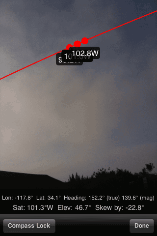

Here is screen shot I just now took from my backyard using Dishpointer AR on my phone
