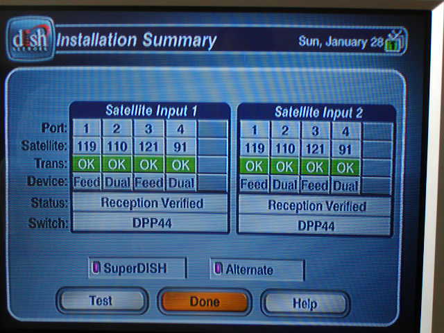

Here are the results of the first test.

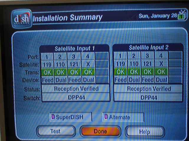

I shifted my 129 to 91 and did a Check Switch. At first it did not recognize 91 and just showed an X; but going into the RESULTS screen, it did show it was receiving both Even and Odd transponders on Port 4.

I then took the 91 feed and put it onto Port 1 and then the Point Dish screen showed it was in fact pointed at BellVu Express 91 (or something like that).
NOTE: Unless otherwise directed by the receiver, the DPP44 will default to Port 1 for dish pointing/peaking.
I then put 91 back on Port 4, and cycled the power. Although the Point Dish Screen did not have a 91 as a selection for Dish Pointing, when I went into Check Switch, it showed 91 as Port 4.
Picture: Screen-02.jpg

I went ahead and put 91 on Port 4. I could not get the 622 to recognize/find the 91 sat.
But once I put it on Port 1, so that I had 91, 110, 121, & 119 on DPP44, and then cycled the power, it found it, so that I had 91, 110, 121, and 119 on the Check Switch screen. It also replaced the Point Dish satellites:
From: 61.5, 105, 110, 118.7, 119, 121, 129, 145
- - To: 61.5, 82, 91, 105, 110, 119, 121, 148
I downloaded the program guide, and ended up with no Dish programming, just Bev programming, but only the free stuff, including the Free Concert Channel.
When I put things back, including 119 on Port 1, then the receiver found the Dish channels. But the sat list on Point Screen did not immediately correct itself.
