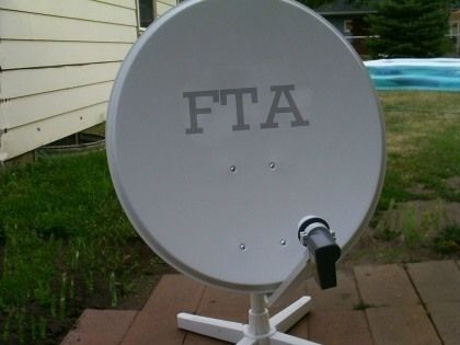

Diameter of mast will be the same so that should slip right on, I posted a picture of a 30" dish I will see if I can find it, maybe it will give you a better idea, of how much lower it will be.
Here it is : ) This dish is 30"

dish stand
Hi Pete,
I noticed that your picture shows a four leg stand for your dish setup. Do you sell these stands or did you make it yourself?
Thanks.
MrM
I don't sell them but they do sell small tripods that may work just like the stands I use, the stand is just a Fan base, I pick them up and use them to display satellite dish, the pole diameter is the exact same as the mount 1 11/16" or 1 5/8" : ) They are pretty stable I don't know why people in apartment do not use this method : ) I have two or three of them! They work good at ground level, and I use them now and again for a temporary location!
