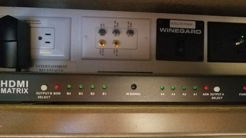

Fellow members, I need help. I have a relative that just got a new RV that has the Winegard RoadTrip T4 In-Motion Satellite Antenna. It also has a Winegard OTA antenna mounted on top of the RV too. He has asked me for help because he wants a DISH satellite system. Looking at the instructions looks like only the Wally and 211 is compatible with this satellite dish. I do not know much about these two receivers. Have the following questions:
What's the best receiver? Wally or 211.
What are all these different versions of the 211 all about? VIP211z, k, etc.
This RV has two Samsung TVs. Will he need two receivers?
There is some kind of Winegard module mounted in the RV. What is it used for? See attached pic.
Will DISH send out a technician to install the Wally or 211? Or does the RV dealership do the installation?
He is new to DISH so what kind of account will he need? He will just need the satellite service for road trips only. Doesn't want satellite for home use.
Can a Hopper 3 and a Joey 3 be installed in his RV if he had a DPH42 switch?
Thanks for any help.

The lower panel shown in the photo is known as a "BOMB" (Box Of Many Buttons), and is an audio/video switching system that supplies signals to multiple TV's.
