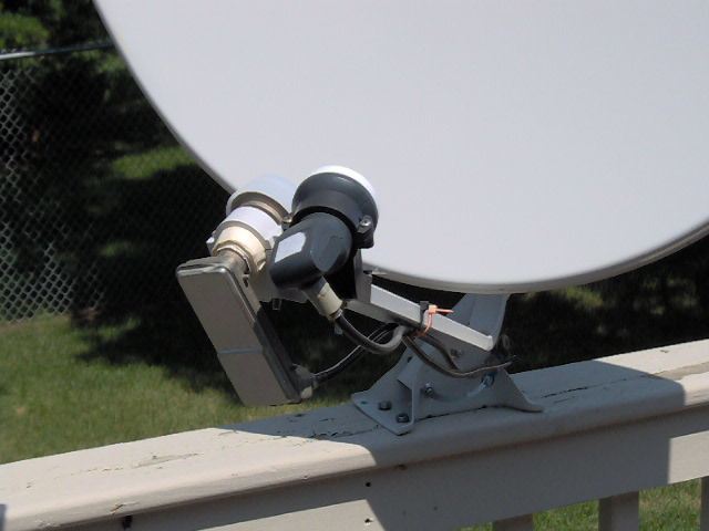

yes it will support the LNB but you have to make some adjustments for it to fit in the holderI have a winegard 76cm will it hold a legancy dual? I could aim that at 110 that should increase signal. Has anyone clamped a dual on a winegard 76 cm, will it support it?
The holder wont fit the LNB as is. You have to remove the plastic from the LNB. The outside plastic cover cracks open very easily. The top part of the plastic case has to be removed so you can fit that into the holder. What I did was wrap masking tape around that to make it big enought to snugly fit in the holder
see attached picture. Thats the LNB with no case on it (the one on the left is for 119..the right one is for Galaxy 10)
