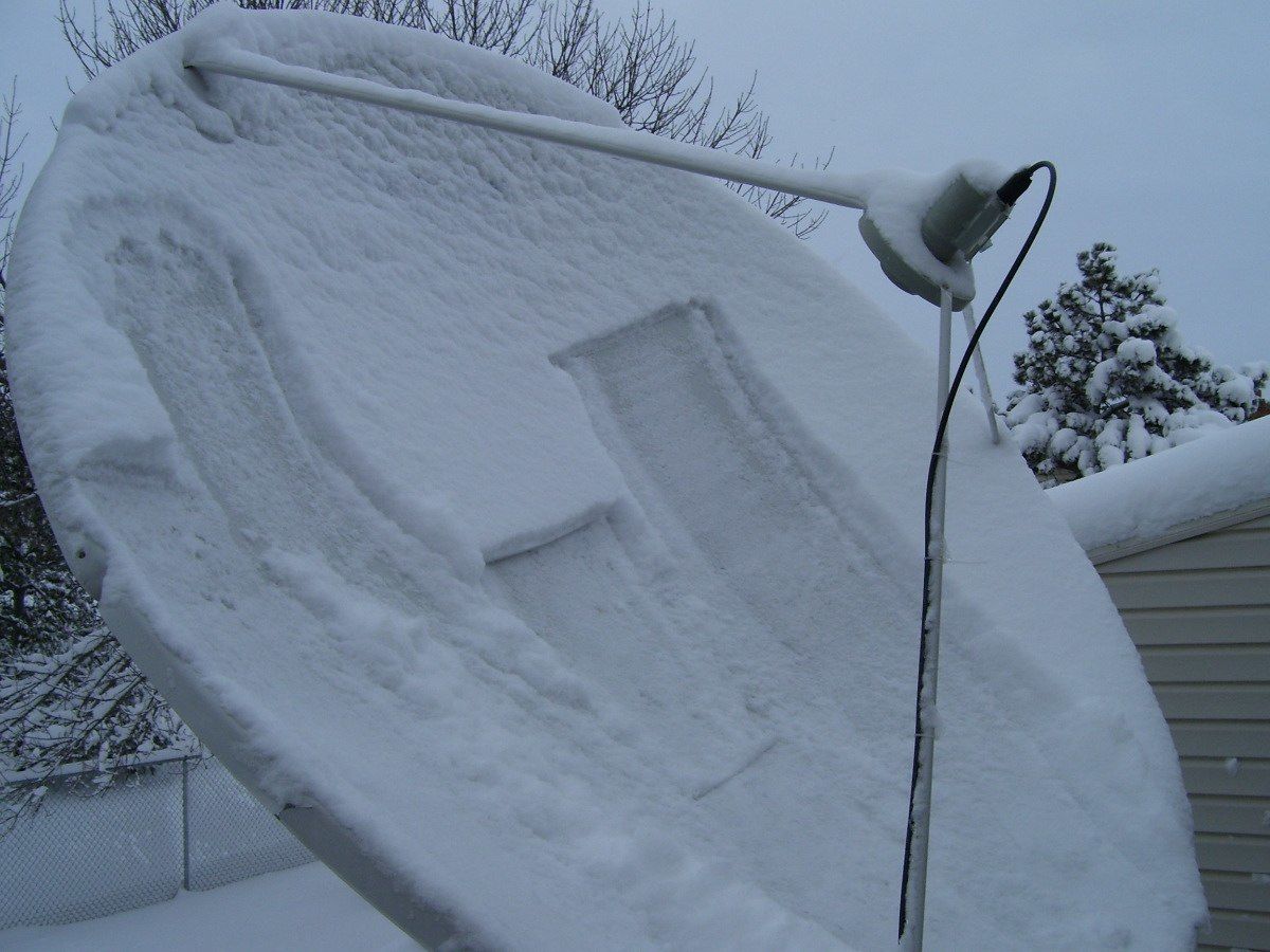

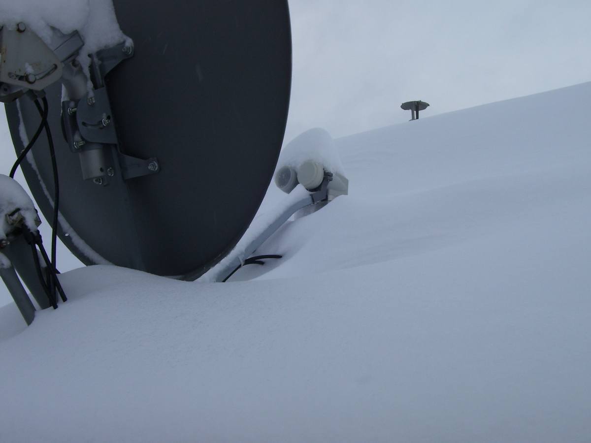

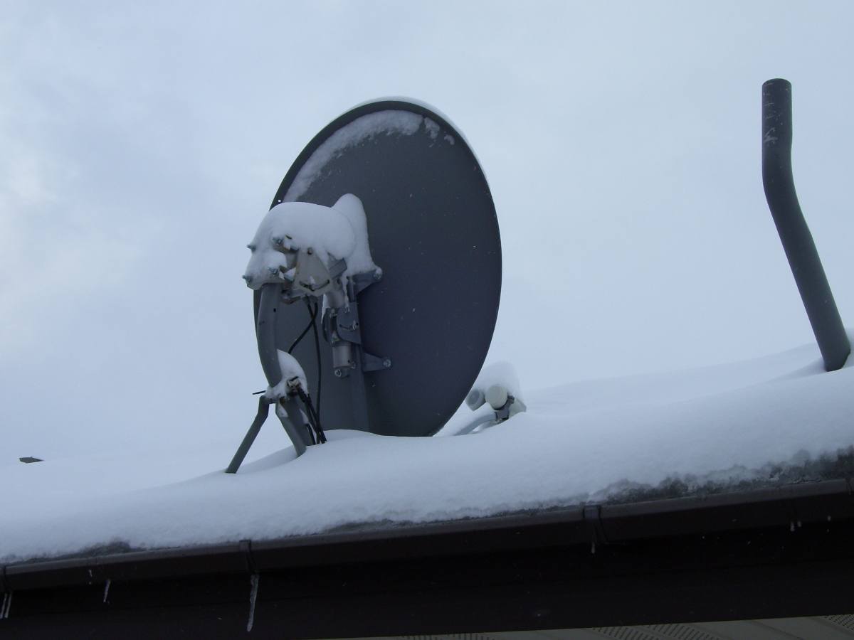

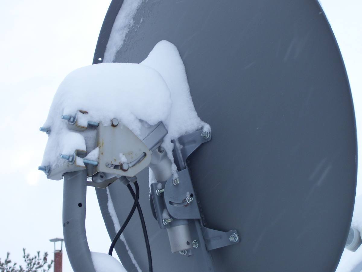

well coming up on my 10th winter with a FTA setup (got setup late 03) I learned to keep the snow rake handy. Due to the position of my dish, the northern location (so the dish is aimed low) and the amount of snow we get I keep the broom and snow rake handy
Here is some pics from 2 years ago when we had the blizzard....The pics of the dish on the roof we get snow like that 2-3 times a year minimum....anytime its over 3-4 inches I get the snow rake out and clean around the dishes or take massive amounts of hot water to it :)

Thanks for the pics iceberg!Im glad that my 6 footor is my main dish and on the back deck :) Looks like around here there may be a few days in the winter that my ku dish on the garage roof may be out of service.Dont really like the thought of cleaning off the snow on that one.
