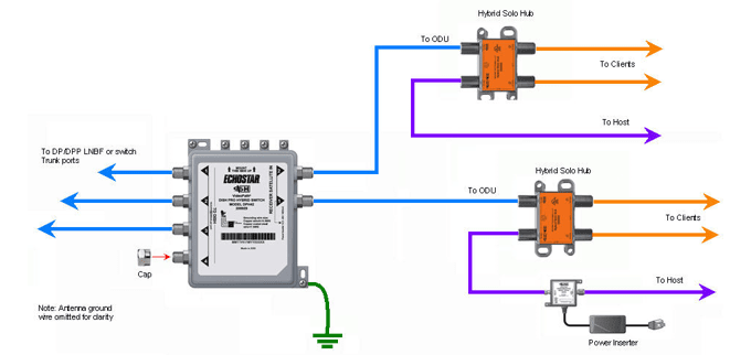

The installation rep is at my home now. He has never installed a 2- Hopper 3 system, and can't find a wiring diagram. Also what type of dish would he use? Can anyone send me a wiring diagram. Thanks.

Here
