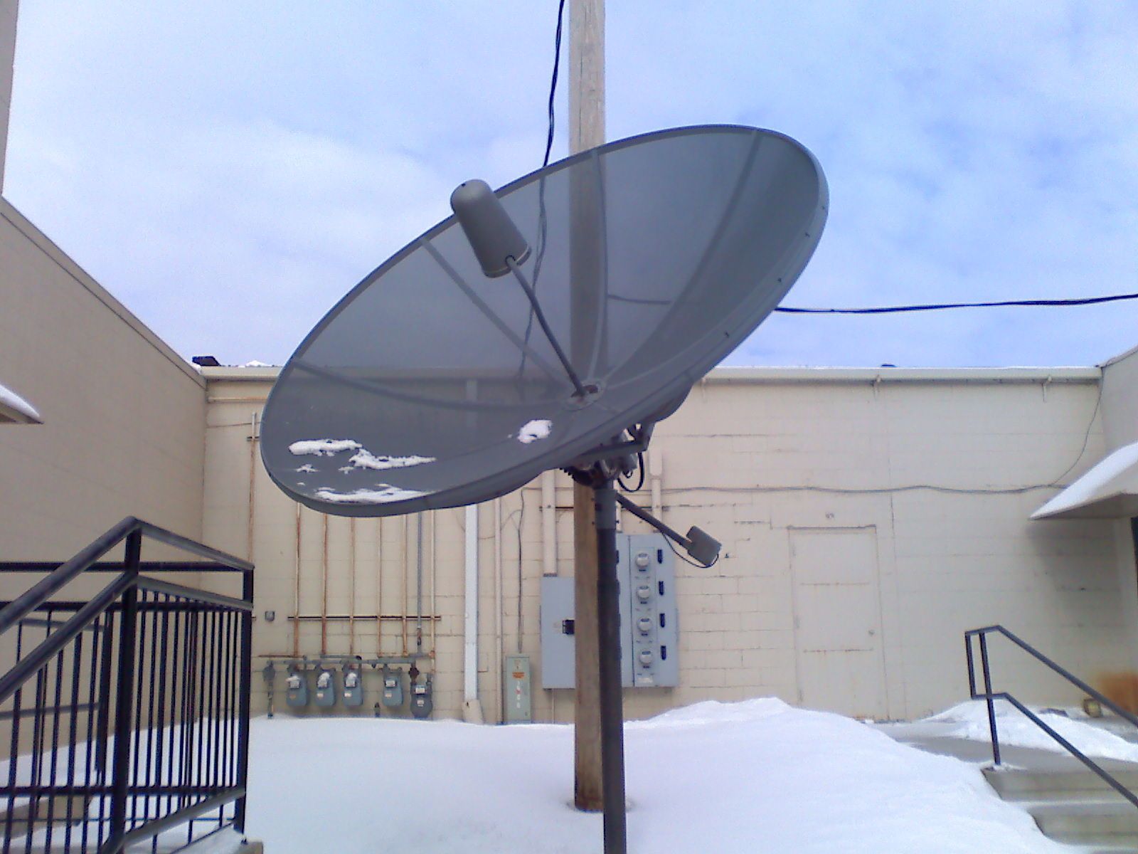

Glad you found one, I'm not sure if the dish or the entire assembly dropped when you were removing it, but since you said it dropped and I'm guessing it was off the mount you might want to do a string test to check the dish out to make sure it OK.
Myself I first remove the actuator and then always loosen all the bolts then remove top three bolts and then rotate the dish down off the mount on the last bolt before removing it. Like you I've got another 10' Winegard to remove next week after I get two dishes in Waterloo on Monday.
As far as how deep for the pole I wouldn't go less than 4 feet deep and a minimum of around 24 inches for the base, but you might need more as it will depend a lot on where the dish is installed and how much protection it will have from the wind, something to remember is it can hold a lot ice and snow in the winter.
I'd go C-Band only just because of the size of the mess holes which makes it harder for KU to work, for KU you want small holes or solid dish. I'd also get a LNBF to replace whats already on the dish as the servo motor is old and will probably be bad, myself I'm now only using BSC421 or the BSC422 models on my new dishes.
