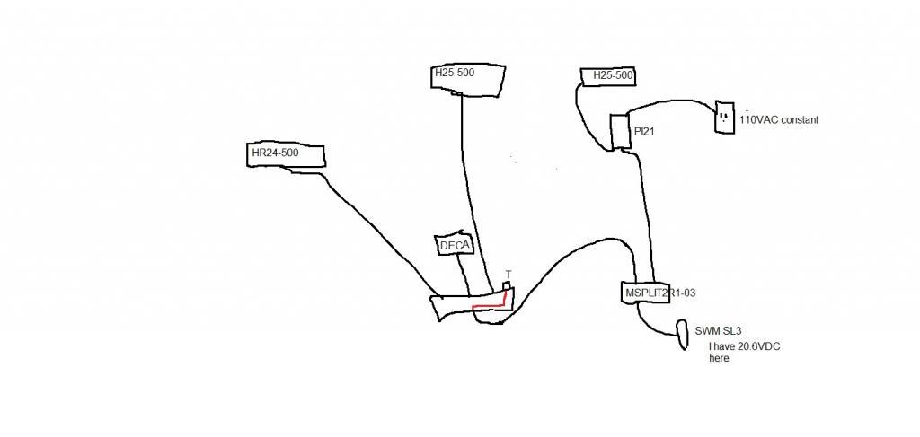

The other day, the dreaded 775 popped up. I have done all the resetting procedures multiple times. I have tried using just one receiver on the system. Nothing has worked. I had a picture for about 30 seconds today after trying one last time, then it went right back to 775. I have posted a very crude, but correct diagram of my system as it is and was installed below. I wanted to get some expert input before i buy an LNB. I pretty much refuse to have a tech out, because this is not rocket science, it's basic signal routing to mostly non-servicable components. Check my diagram and make sure everything looks up to snuff as far as routing and placement. System has been running fine for about 2 years i believe.

Randy,
Your rig looks ok. A few EZ tests =If you have NO HD service or IF every other transponder is missing from the 101 sat.IF you are receiving service from the 110 sat or the 119.....these will have missing channels.Finally, the problem will be on all TV / receivers. IF one set works normally the problem is not the LNB.
Report what you find.
Joe

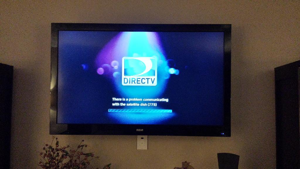

Thanks, Joe. No receiver in the house will make it past startup. They all stop here. 20131223_170455_RichtoneHDR.jpg
The transponders all show zeros and N/A.
Signal meters show "Not aquired" and are blank.
System test shows "SWM not detected"

Is the power inserter plugged into the wall or a power strip? If a strip, try plugging it straight into the wall. I assume the power inserter is on the power passing leg of the splitter, otherwise it would never have worked correctly. Check that anyways. Also, check all of the cabling and connectors, especially the ones from the 2 way splitter to the dish.

At this point, I don't know what else it could be. The PI is sending 20.6VDC to the LNB. I've tested it with a DVM. The system test says "SWM not detected". I see some replacement LNBs for not much coin. I'm gonna take the "plunge". Have a good Christmas.

When you tested the voltage, was that from the output of the power inserter or at the end of the cable where it enters the dish? Just curious for future reference
Run a new cable from the lnb through the power inserter to your receiver.
Just run it through a door or window as a temporary setup.
If it works, then you got a bad connection somewhere.
If it doesn't work, then test the voltage on the coax going out on the power inserter, and that will tell you if your lnb is bad or the power inserter.
