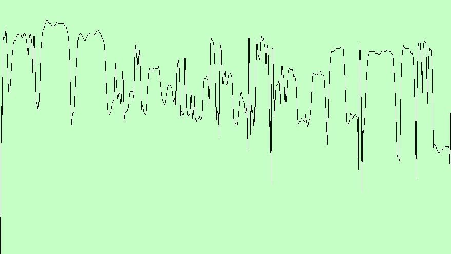

That AMC-21 sat is sure FULL though. Virtually every transponder in use, although most of the signals there I can't lock, as they are apparently in modes I can't tune. Just as a demo of how full the sat is, I'm attaching spectra of the two polarities below. In the first horizontal scan, at the right you can see the three 4444 signals, the 12150, 12120, a narrow 12098?, and the 12072 LPB signal, all quite clean and strong, but for some reason, I can't lock the LPB today. In the 2nd vertical, you can see from the right, the 12180, 12140, 12112, 12104, and 12096 signals. But you can also see a ton of other signals on both polarities, a few of which I can lock, but most that I can't. That sat is full of signals.
