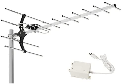

What you want is a preamp, not a distribution amp. The preamp has a lower noise figure, boosts the antenna signal without adding much noise. With marginal signals this is important. The amp you describe with the splitter built in is a distribution amp it is designed for in the house use for driving multiple TV's. Of course it is best to use a higher gain antenna, which may be enough by itself. A photo of your amps, or giving brand and model would help. Ignore the signal readings you mentioned, you could probably pick up the full power station with a paperclip antenna. Even the coax will act like a (poor) antenna. Good progress! Here is another antenna idea, if you can tolerate it get a small Yagi antenna and put it in your window, or suspend on the ceiling. They can be had for under $30 this one has a built in preamp. Highly directional, point it at the tower. About 2 feet long.

The one that I just unplugged was an RCA VH140R from my cable days when it seemed the full power station interfered with Ch 85 ClearQAM.
The other is a GE 33341 one.
I was looking at this one as a test but I can't find many details about it at all.
onn. Indoor Passive Antenna Amplifier, Onb17Ch001 - Walmart.com
It also has an outdoor sister but I don't know if it's basically the same rating or not.
It seems no dB or other numbers are given at all. All I could find was a video review of a person from nearby State College (same DMA) who had great luck with the outdoor one.
None are what you want for a preamplifier. You want a preamp with good overload protection because your full power station could swamp the thing with it's killer signal, something like a Kitz KT-500. Your amps are distribution amps, a no-no stay away from that Walmart thing. Try a better antenna first, you may not need a new amp. Get it right and your HDHR will drive all your TV's easily.
