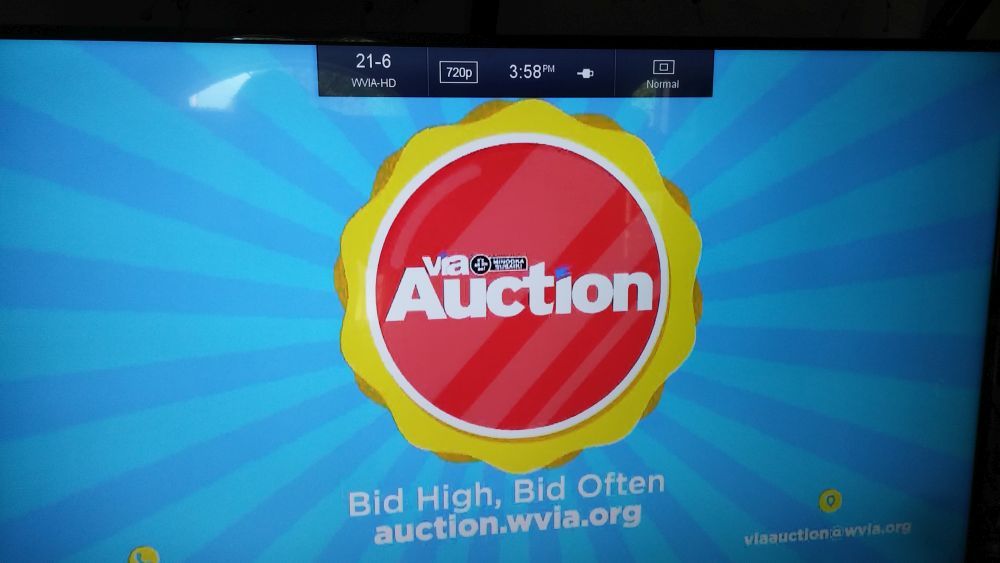

This is getting weird. While doing the rescans this morning here's what happened with the big Vizio. I did a fresh scan. No luck with 22 & 28. In an earlier post I mentioned that annoying station out of Phila (WMCN) that scans in and occupies 44.1 instead of the legit 44 (WVIA) out of SWB and it did it again this time. Here's the weird part, WVIA actually did scan in this time but at 21.6! What the !!?? With this messed up repack I'm becoming good friends with Dr Jim Beam! :coco

Weird but kind of makes sense as WNEP 'hosts' WVIA and they are broadcasting on RF 21. :)
