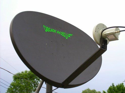

What is the primestar 40x30 equivent to? 90cm or 120cm?
And do you have pictures of the primestar with the c band lnb?

Based on the surface area of the 40x30 I equate it to a 90cm.
I didn't take any pictures - and I now have the Ku LNB installed.
But here is a picture I found (think it was on this site) that gave me some inspiration of how to mount the BSC421.
I drilled a hole in the angle plate at the end of the arm on the p*
The hole lines up with one of the threaded holes in the scalar ring,
so that the inner lip of the scalar rests in the half circular notch of the angle plate - where the Ku LNB mounts.
