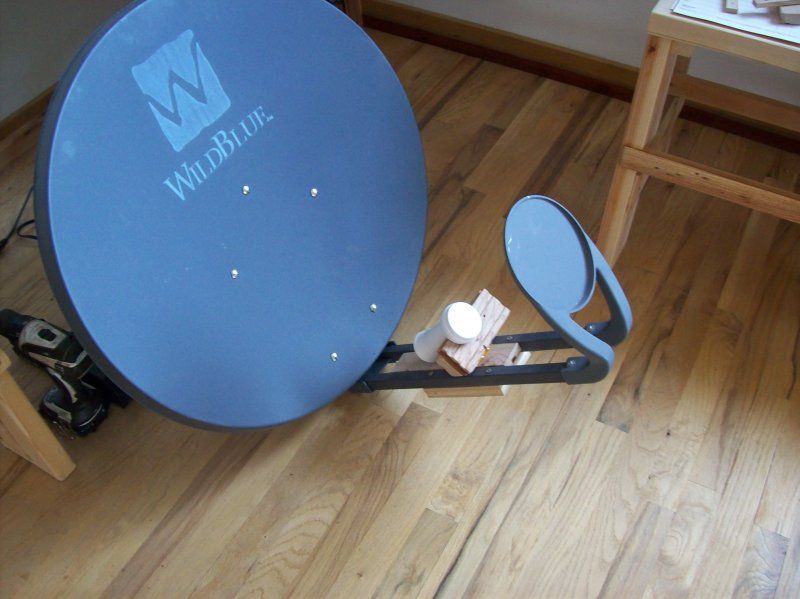

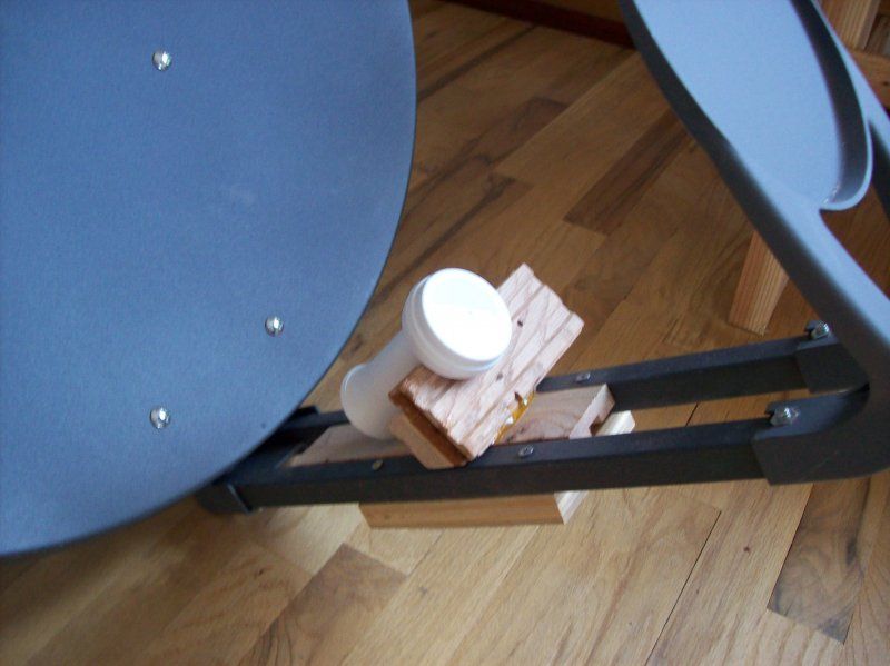

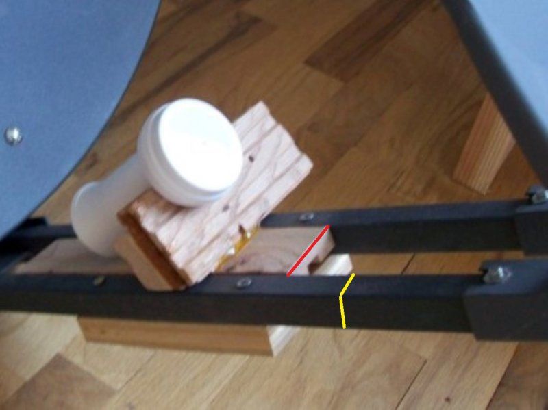

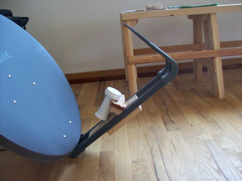

this is what I came up with. A sled that runs inside the rails made of scrap oak. It slides smoothly and I can experiment where it should be exactly.I angled the LNB holder part at about 12 degrees.It seems to point at the sub reflector...I will have to strap the LNB down ....
I repurposed the mounting bracket years ago and use it to hold a cell antenna .....Where can I find another one that will fit the WB dish??
I might be able to make an adaptor that joins the WB dish and my DISH network bracket and re enforce it to make it solid....
I could add some arms easy enough....but it would be better to just buy a used bracket if I could find one for 5 bucks.. 100_1556.JPG 100_1555.JPG 100_1554.JPG

3d1r I can make new LNB-holder for your WB antenna. It will be fully adjustable (sliding between the rails, LNB-height adjustable, and also leaning of the LNB adjustable). If interested, do precise measurements which I marked on your picture:1 red line and 2 yellow lines (in mm, please) and PM this data to me. 100_1555 (Large).JPG
