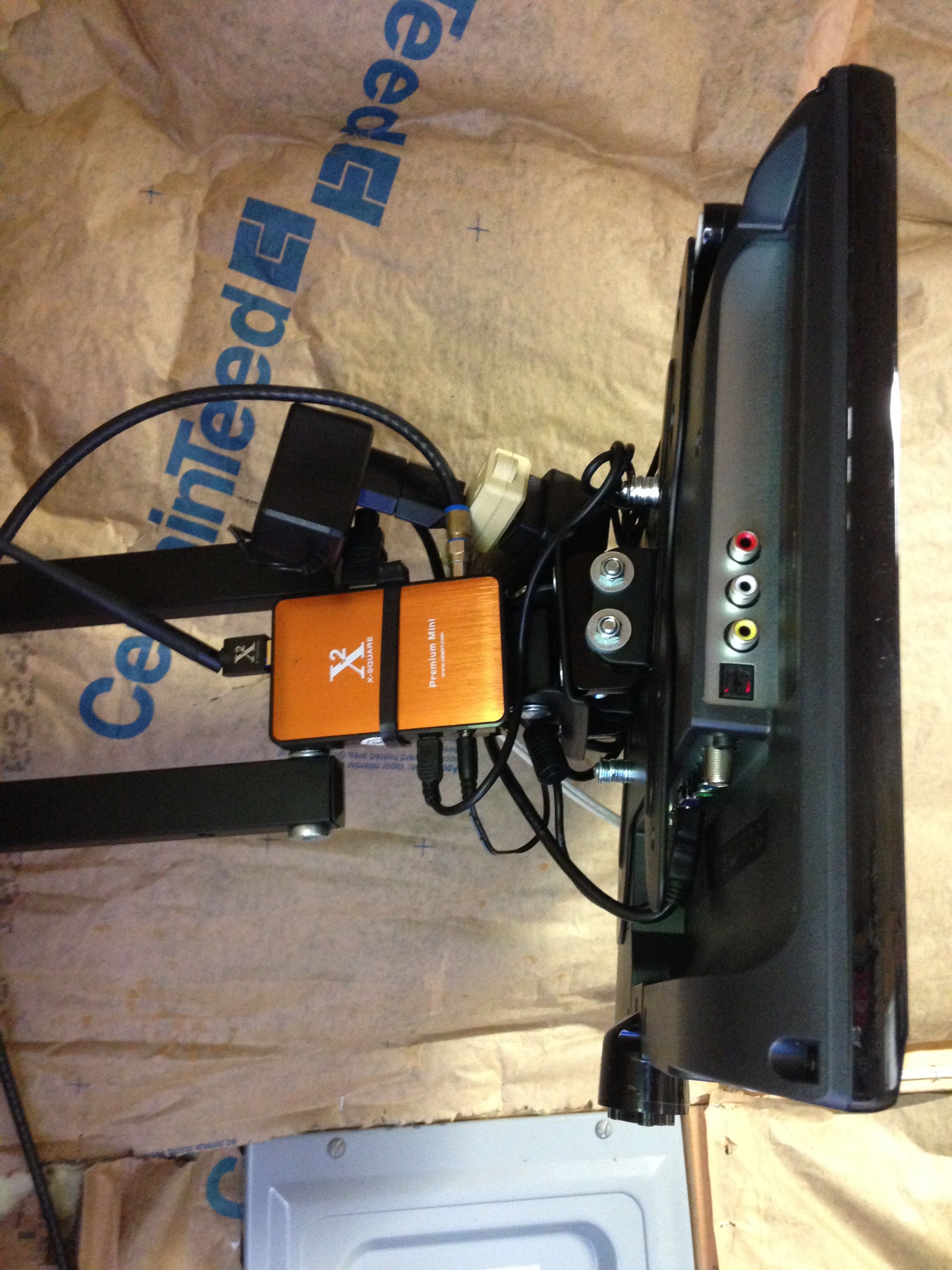

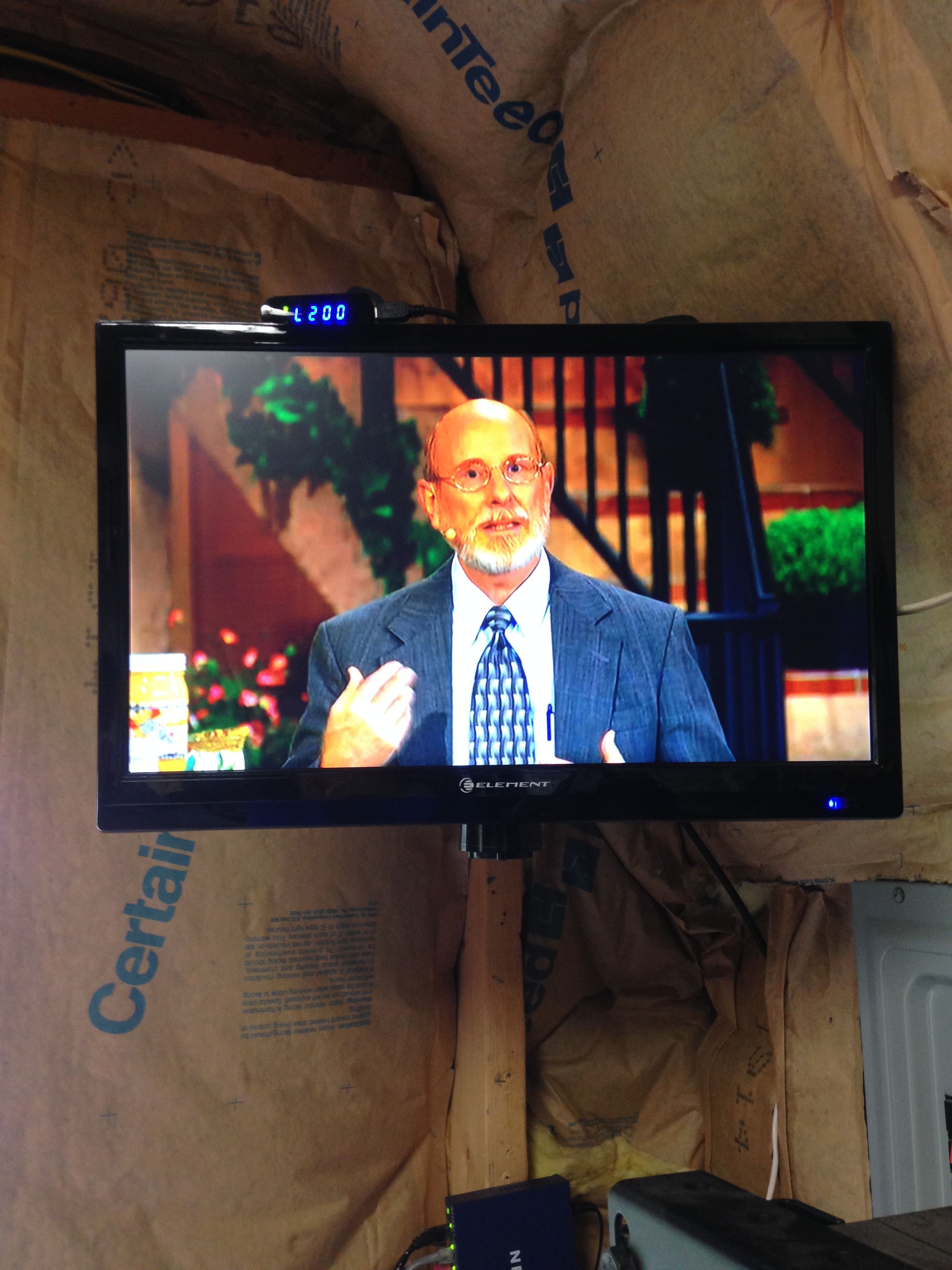

Here's my report on the X2-premium mini. I received it in about 5 days and it was packed well. I hooked it up in my small shop where I had limited space. I had to manually some transponders that weren't in the satellite list but that was easy to do. The blind scan seemed to work best and it was pretty fast. The picture quality was excellent as was the audio. I am running it in HDMI. The most impressive thing was that it actually did find the trouble transponder on AMC-1 KU (11840) on a blind scan and DID find and lock onto Cozy. I was in disbelieve at that aspect. I was ready to have to manually add the transponder and hope it would lock onto it. Signals on that transponder were much better than I would have thought. (S-78% Q-59%). The Openbox S-9 that I had there would not lock on the transponder. The internet TV features were also impressive as was the YouTube feature. Overall I am very happy with this unit for what I am using it for. A fast wire tie job to the TV mount and a peel & stick with the IR remote and I was done. I give this unit a thumbs up.
