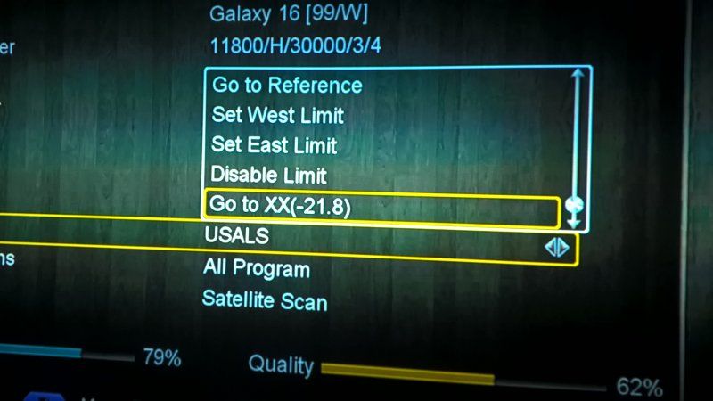

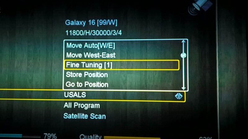

I had issues with it pointing in the right direction when I used the "GOTO Position" option in the USALS menu but I found that using the "GOTO XX" option works much better. It gets the sat right on and works on either side of my Longitude. For fine tuning the sat position I use the "Fine Tuning [1]" option and hit the left or right arrow on the remote. It moves the dish a step in the indicated position. Not sure if the 1 can be changed to another value Once I get the highest Q possible I use the "Store Position" Option. I haven't had any issues with it either USALS or the receiver rebooting since. See images below.
