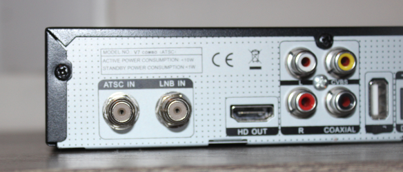

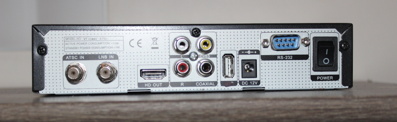

Now there's " a pig in a poke" ;) Lots of conflicting info there. If you look at the picture posted of the back of the unit you can see right away that can't be right. Wrong kind of connectors. Caveat Emptor!

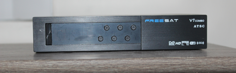

You are correct. I see that the 'current' release states ATSC but does not have the right connector pictured. Here is what the front and back of my Freesat V7 Combo ATSC (that I bought quite a while back) looks like. As you can see it definitely has our US OTA connector. :)
I have one of those V7 Combos also. I haven't used it in a long time as I usually watch ATSC with the MIO Webif function on my PC. I like it better for recording than the freesat too.
