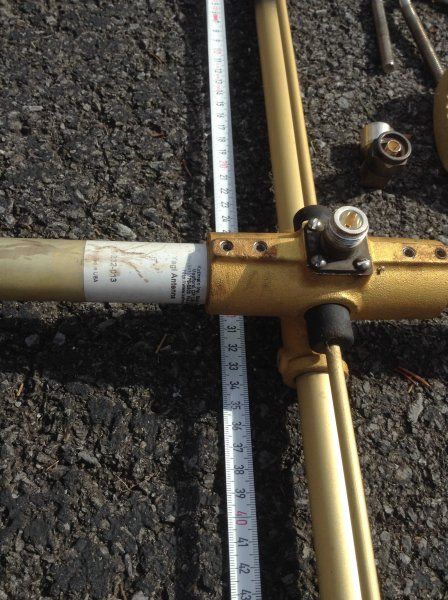

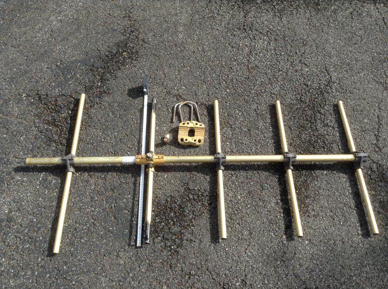

Several years ago I rescued this antenna from the metal recycling container in town. At the time I thought it might be useful someday. It measures 130cm long with 5 elements that are 62cm long. The way the u-bolt bracket was installed, it was previously mounted vertically.
Think it might be suitable for some future amateur radio use?

It looks like possibly a yagi of for 220.

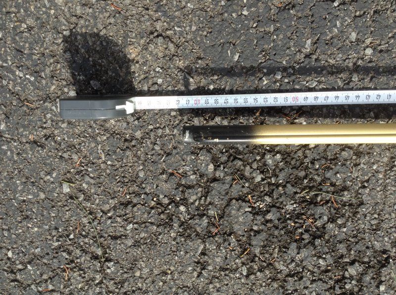

Are all the elements the same length...they shouldn't be.
I took a closer look and sure enough the elements are different.
The longest is 67cm and spaced 30cm to the fed one at 62.5, 60, 59, 58.
The remaining elements are 26.5cm apart.
