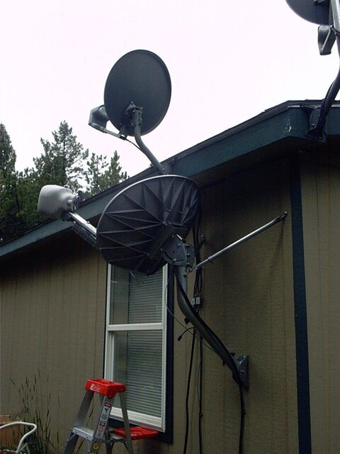

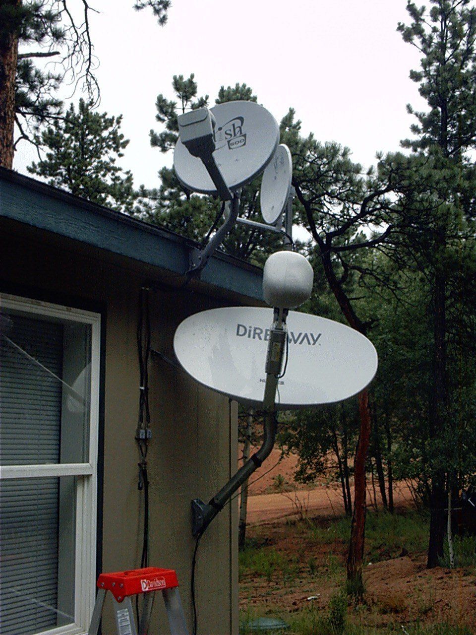

Here's my setup.
Note that my DirecWay has 2 stabilizer arms. a DW dish is the same size (but a little heavier) than a SuperDish. This unit has stood up to 30+ MPH winds without issue - and remember, a DW is also a transmitter - much more sensitive than a SD.
Also, note my Dish 500 & Dish 300 mounts - soffit - but screwed to the underlying lumber. They also have no wind problems - even though the Dish 300 has an 18" extension welded to it so it'll clear the roof.
The point is, you CAN do things that LOOK incorrect, but are actually A-OK.
Please - no comments about my SW-21s or ground blocks not having drip loops. Remember, the cobbler's children have no shoes. :D Actually, there are drip loops above, and that part of the wall is well-protected - almost never gets wet for some reason. I'll redo them someday - probably when I upgrade to DishPro. :p

SimpleSimon; what is that on the mast of the larger dish in the 2nd pic?
Looks as a spring or coil of cable.

What is that on the mast of the larger dish in the 2nd pic? Looks as a spring or coil of cable.
It's the transmitter amplifier. Oh - and it's on the LNB mounting arm, not the mast. :)

Sorry, wrong terminology.
Transmitter????? This is a UPlink?
Yeah. Modern satellite internet is 2-way. The original DirecPC had satellite downlink and dial-in for the other direction, but StarBand and modern DirecPC actually transmit what you send up to the bird. That's one reason why there's so much propagation delay. :( Nature's speed limit of 186K miles/second really adds up when a 'ping' has to travel over 88K miles.

Actually I meant the Amplifier on the Arm of the DW dish....
