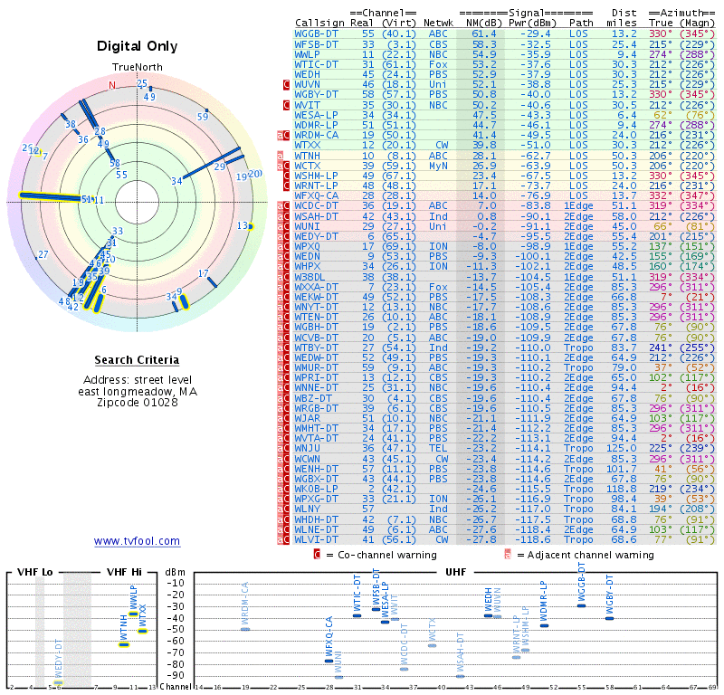

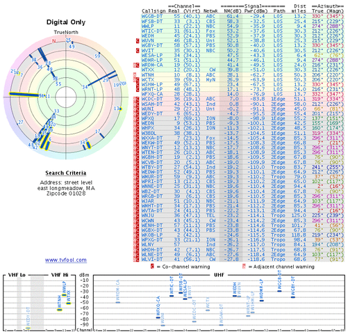

I have also attached my result from tv fool.

You have a problem common to your neighbors in CT -- namely, signals coming in from a wide arc. (I used to live there. Trees+hills+stations all over the place = A real barrel of laughs for OTA reception.) Trees, which tend to be quite hard on UHF signals, are another widespread problem for OTA viewers in the Northeast thanks to heavy forestation in many areas.
If your viewing room has windows to the northwest, west or southwest, first try moving the antenna next to the window. Avoid trying to capture signals through an aluminum screen if you have them -- they'll pretty much kill any chance at reception. If the antenna's cable won't reach that far, buy an extra length of RG-6 cable and couple the cables together with a barrel connector to form an "extension cord." If the window trick doesn't work, try other locations in the room. Sometimes, the last place you'd think to put an indoor antenna works the best. Re-scan for OTA channels after each move.
If nothing seems to help, the attic or roof may be your only alternatives for reliable reception. Write back and let us know if this is the case.
In addition to the multiple directions that you would have to aim a proper antenna, the signals that you do have are too strong for the amplified antenna that you have. When an amplifier is hit by signals that are too strong, the amp creates spurious signals that tend to cover up the weaker stations.
Next, the typical trail and error adjustment to eliminate the strong signal overload cause an unwitting misalignment of the antenna, which can result in the loss of the strongest stations.
So, what can be done cheaply?
Get a 4220 for the Hartford stations, a second 4220 for WGGB, and a Y5-7-13 for WWLP. Get a Jointenna for WGGB tuned to channel 20. (It won't work until February) Buy a UVSJ to add WWLP to the UHF antenna.
It can be mounted in the attic.
