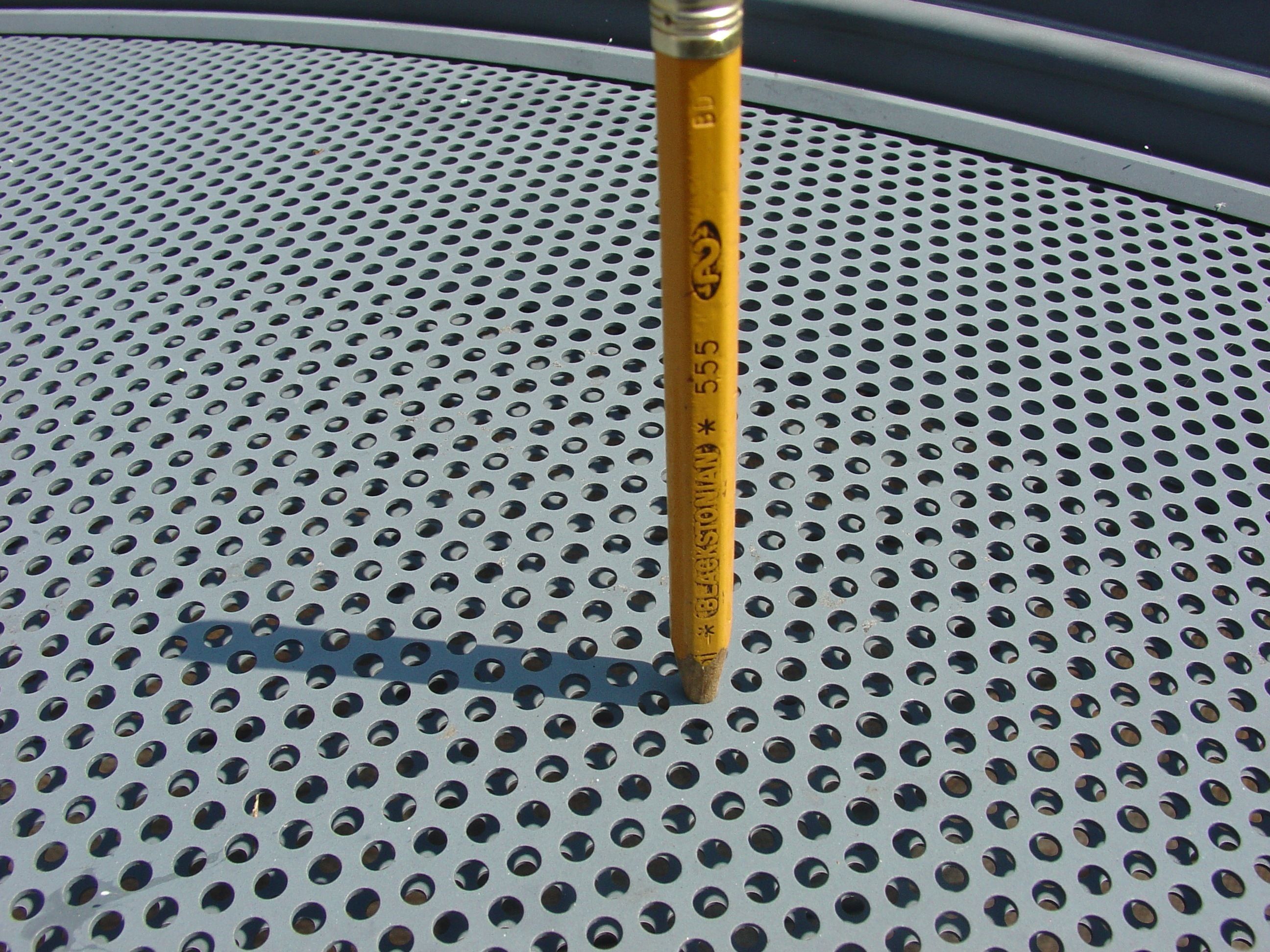

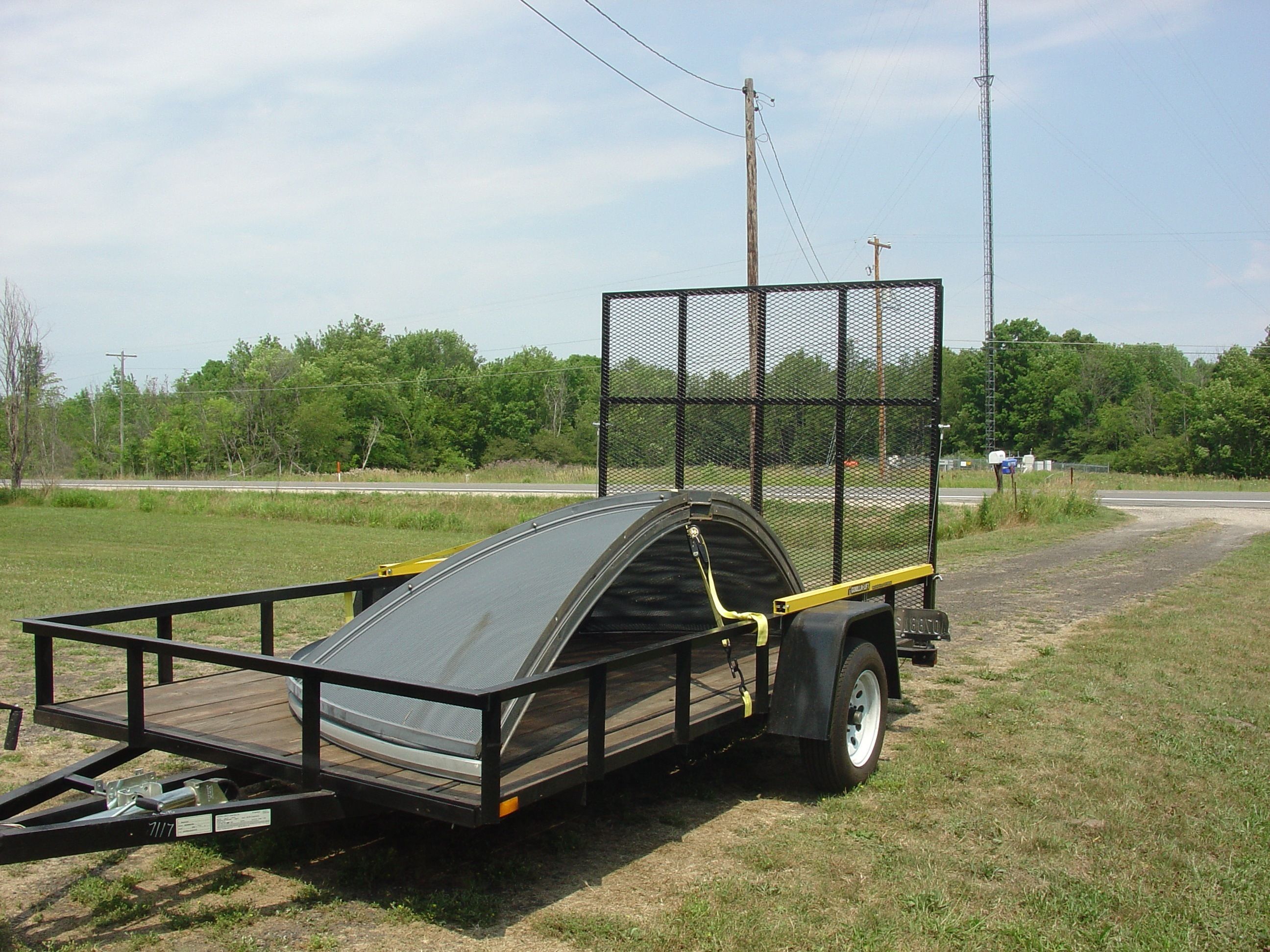

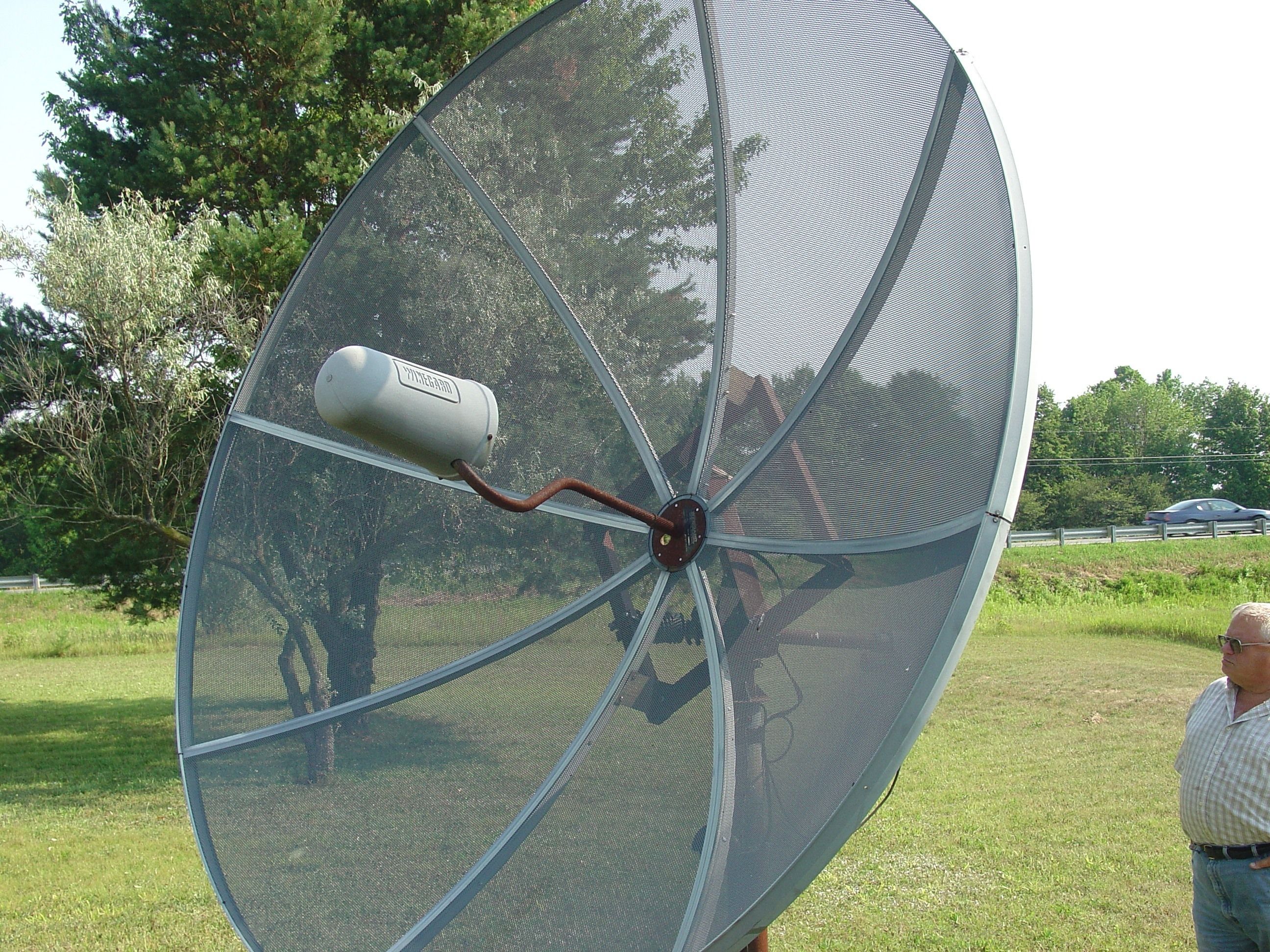

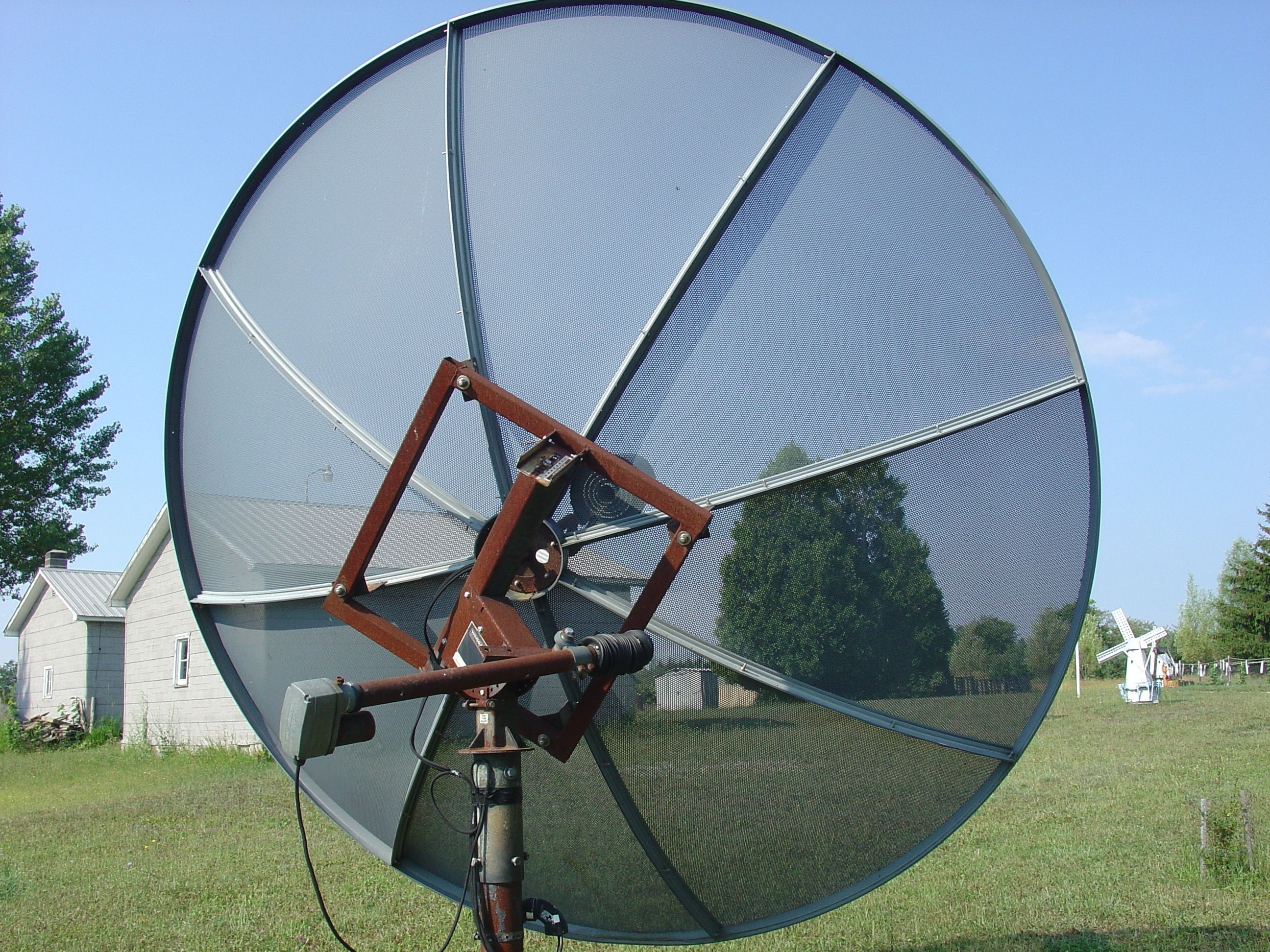

Well we went out to the dish today with all the tools and then some. 90+ degrees! When you get East of Custer Michigan and away from Lake Michigan the temp goes up. A friend of mine and I took it down today. Real short of time, gotta get to work, so only a picture or two. More when I get some more time. I still wonder just what that dish is made of. we could pick it up and it really wasn't heavy. It is a ten footer. Not me in picture.

Nice! That's a Winegard Pinnacle perforated. I have one on an AJAK. Very good dish, very deep dish .28 FD ratio.

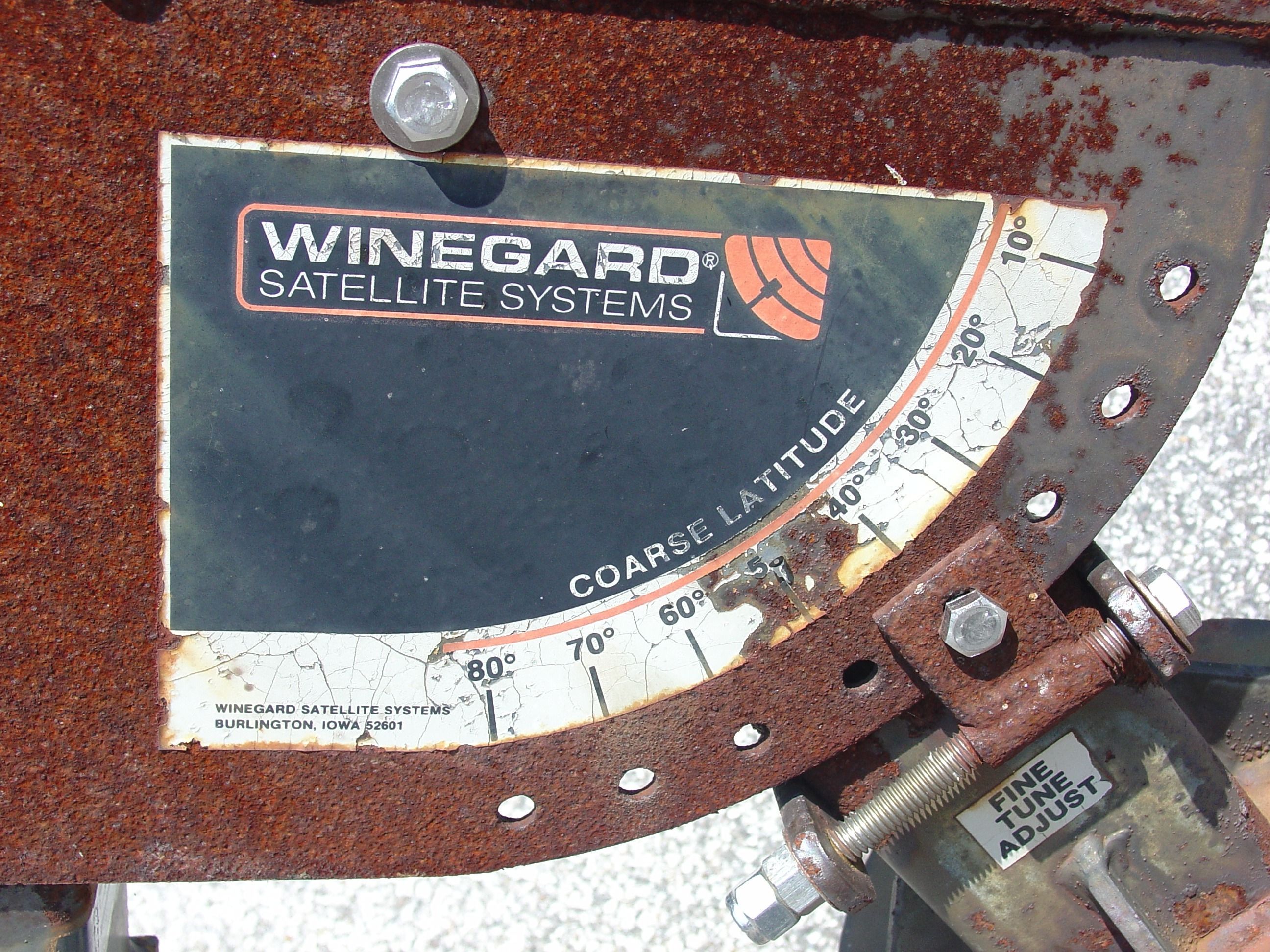

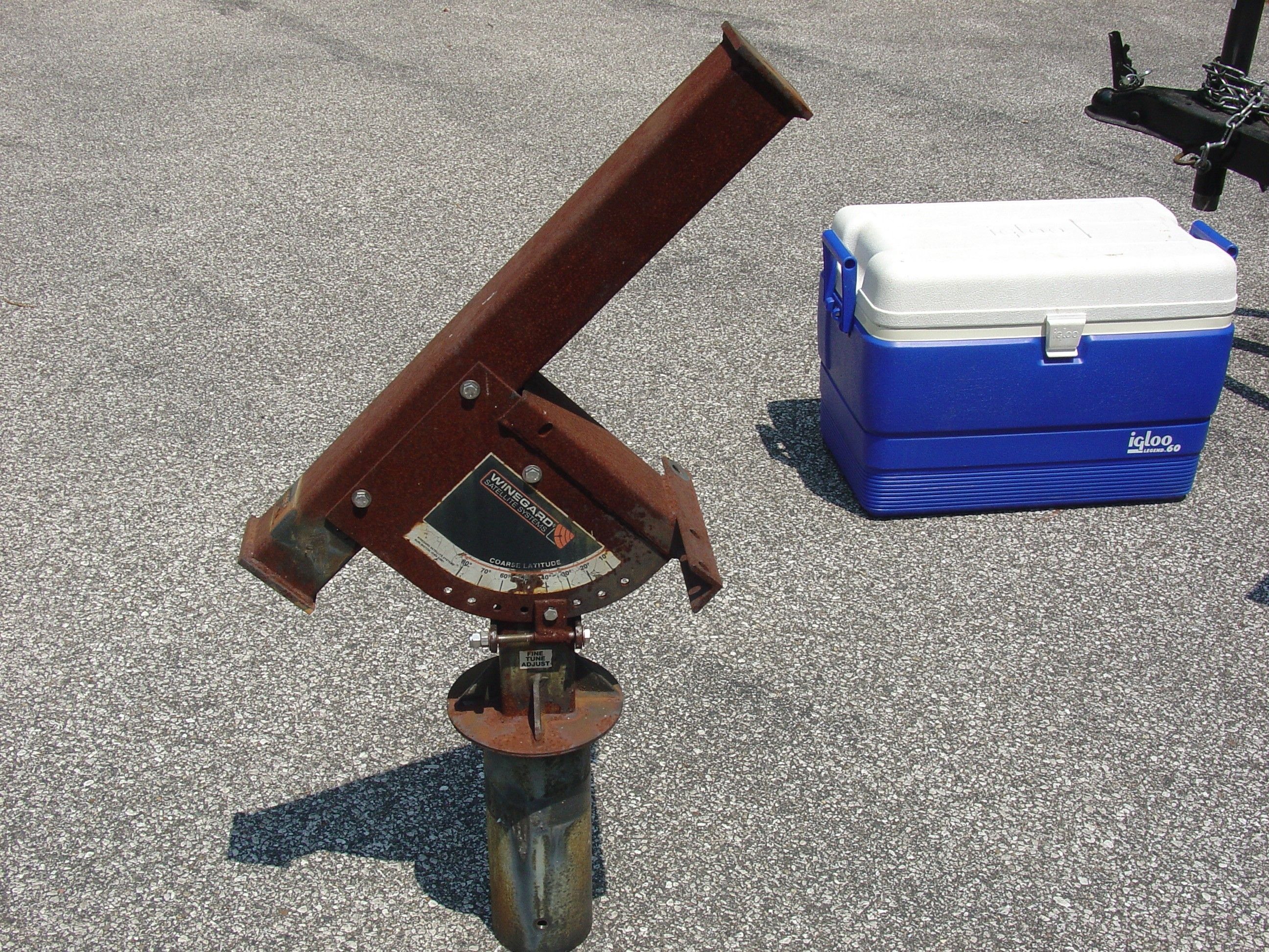

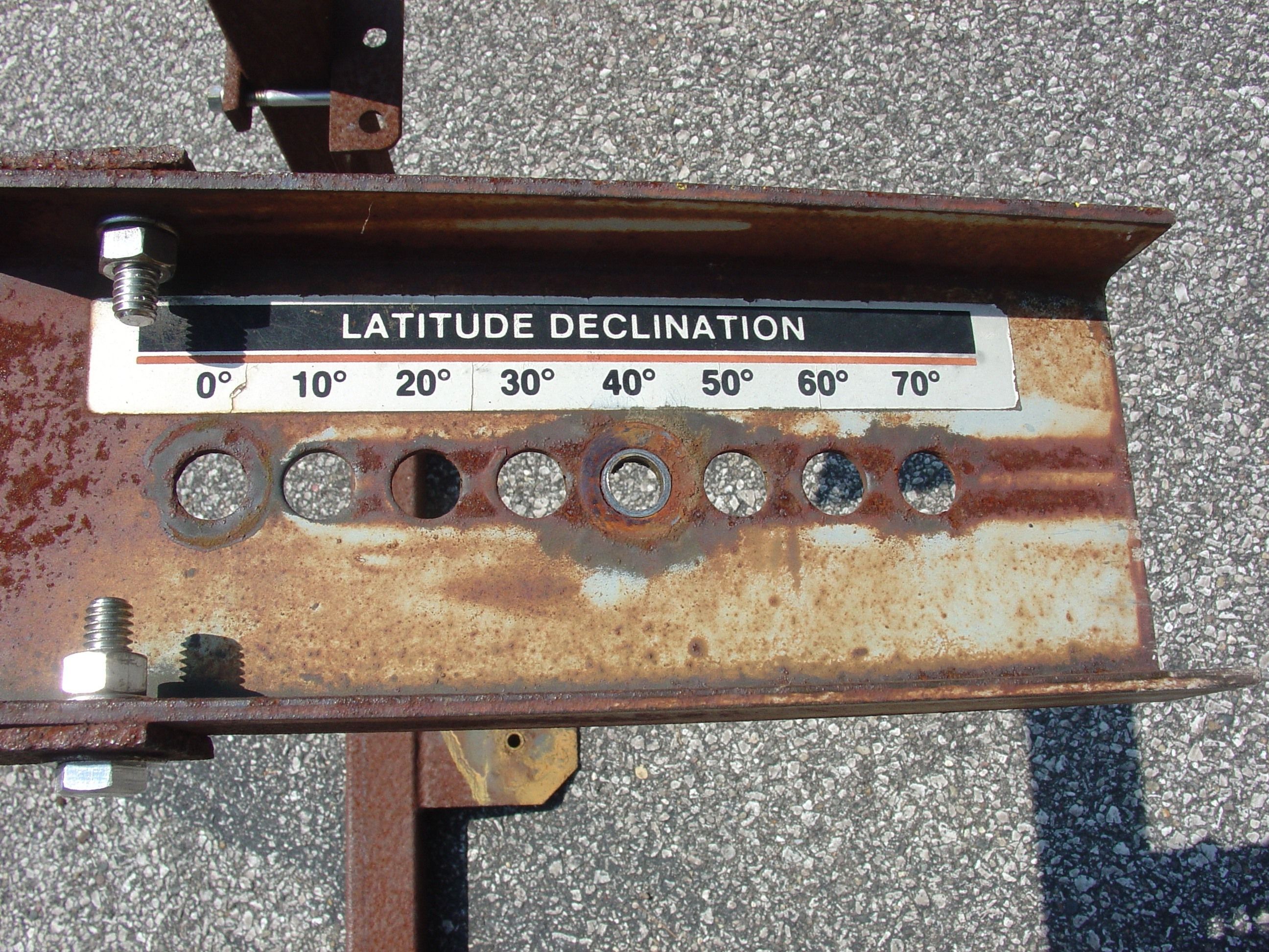

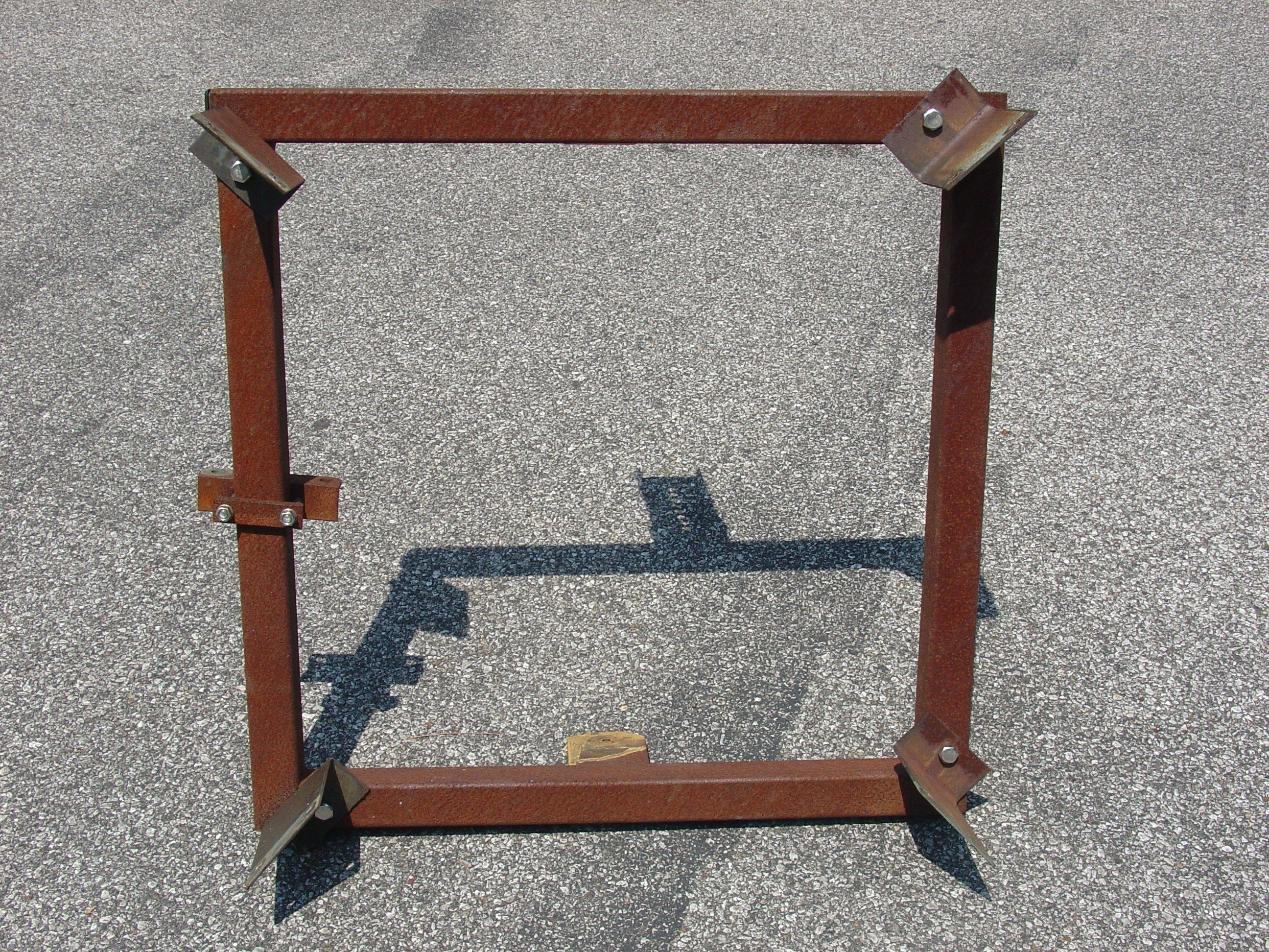

OK, I found some more time. I don't have any "take down" pictures because the friend that helped me was "uninterested" and I wanted to get the job done ASAP. We took the button hook off and pulled the Thomson mover. Turned the dish to one side and had it then very close to the ground. We pulled the top two frame to dish bolts, the left and right side sets, and then one of the bottom ones. That allowed the dish to swing to the ground. Took out the last ss bolt and let the dish down flat. Took off all other stuff and cut the post off at cement level. Owner did not care if the concrete was removed. Lots of rust on most of the parts except the dish. Will "play" with the mover today to see if OK.
MS and Rowdy - Since you have one, what is this dish made of?
I have read that button hooks are not the best for stability. Questions would be if building a three or four arm mount would be a good idea? Another would be would changing from my 8 foot orbitron to this 10 footer be worth the work?

The dish is aluminum. Very well built. As button hooks go, that is a a real short one becuse of the deep dish. So more stable than the longer ones. My dish was converted to a quad leg :) Check the links in my signature.
